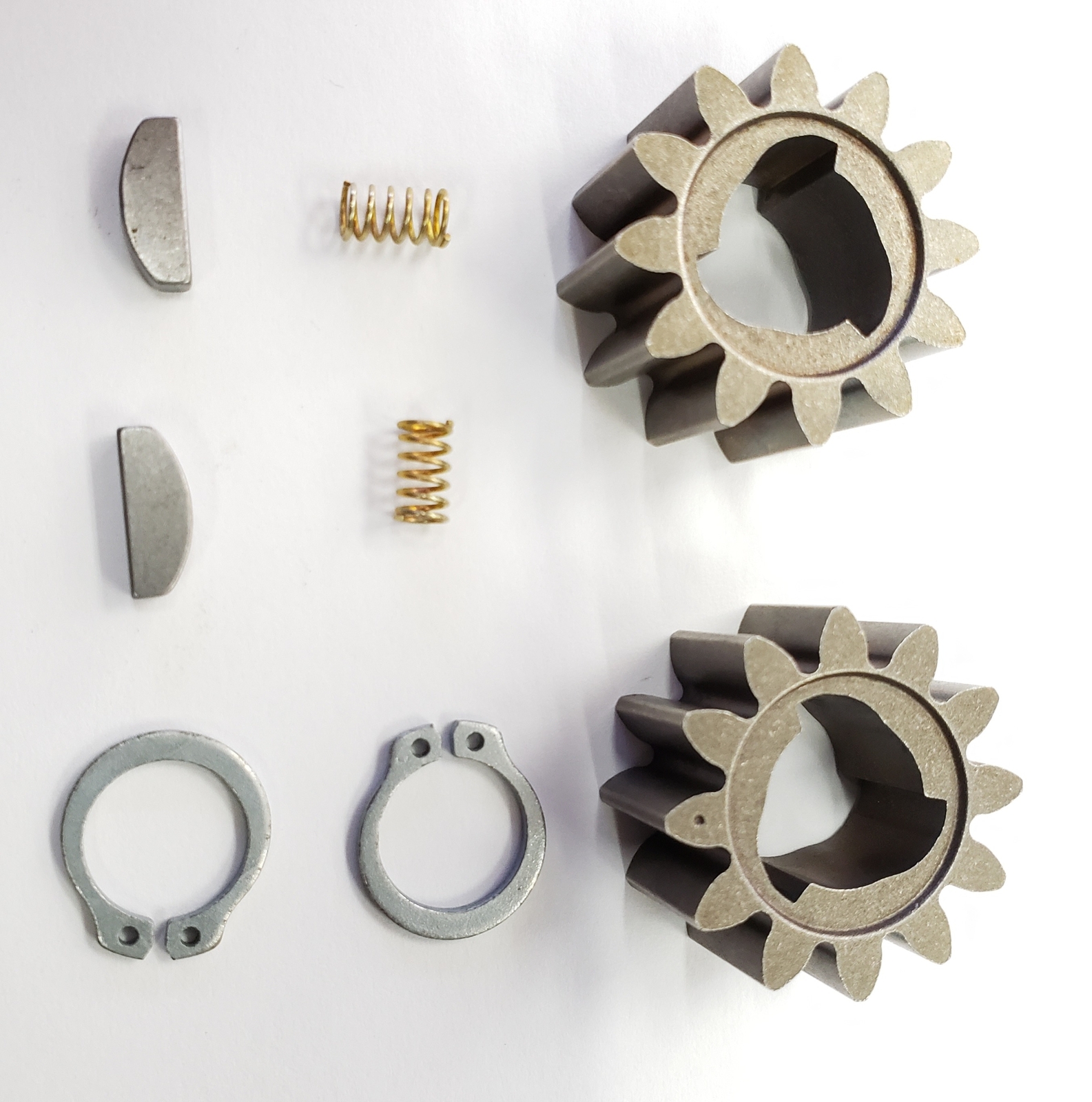

I second what @bcossa2020 says. Take off the drive gears, make sure they're in good shape (keys and springs), and make sure they're installed on the correct side. With the engine not running, your mower should click when pushing forward. If it clicks when pulling the mower backward, they're installed on the wrong side and you'll have no propulsion.
The drive gears look like this:

Those keys and springs are interesting engineering...I can’t get it straight in my head how/why they work.....
The gears are on the same sides they always were, and the ratchet keys click when the mower is pushed forward.
you have to flip the gears around. The part facing outside should be facing inside.

I'm not sure I understand. If I flip the gears around they will only operate properly when I pull the mower backward. The flat edge in the photos posted above will catch on the ratchet keys if I flip them and try to push the mower forward.

Like you've found, the small drive gears above are machined in the inside like little one way clutches. This is why you can freewheel the mower w/out and have the drive system going at the same time. Flip those gears around and you'll only be able to freewheel pulling the mower backwards.
