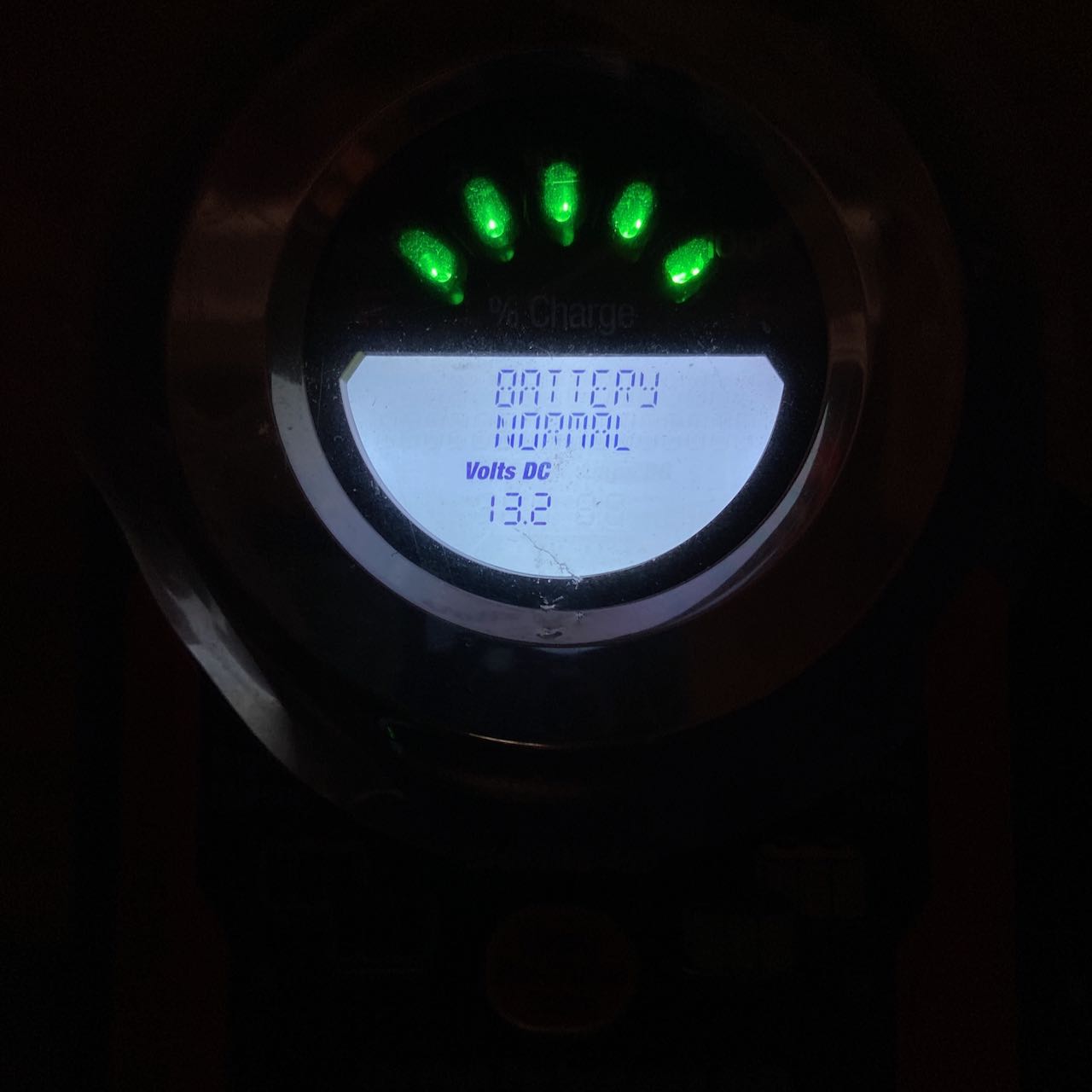

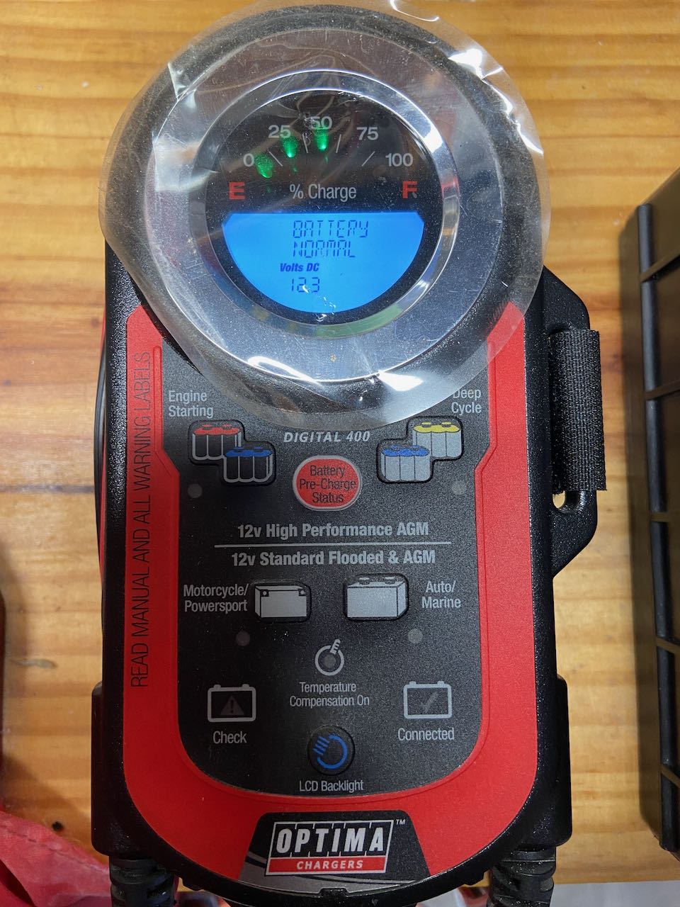

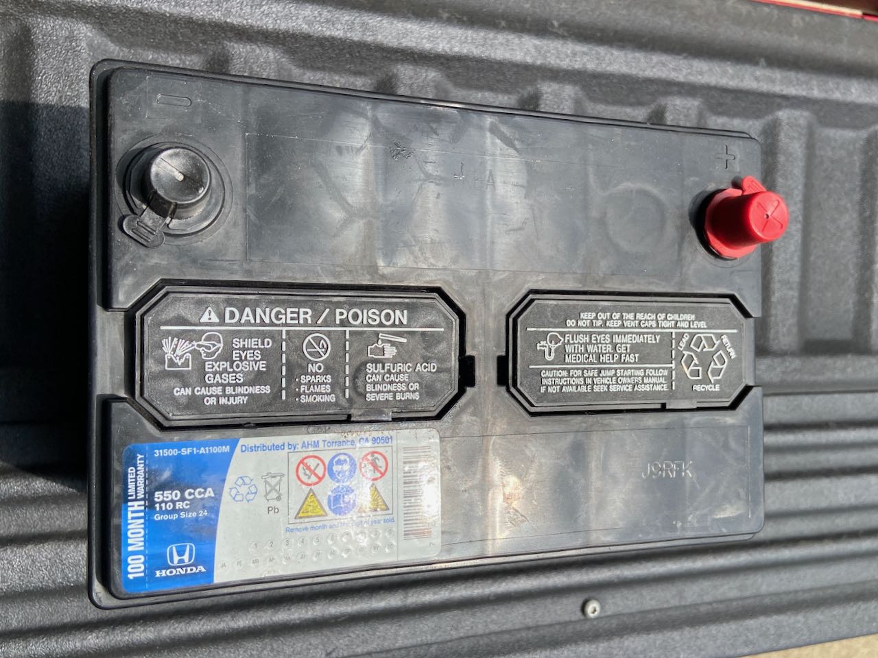

Production date on that battery is 10/19 - “J9RFK” J=October, 9=2019. That should explain the low charge on the battery.
24 group size isn’t too uncommon but I believe you are correct on the longest warranty battery being it’s 100 months warranty. 36 month free replacement and 64 month prorated.
I suspected it might be pretty old, I believe this battery only goes up until about 2000 in Honda’s and don’t imagine there is a ton of dealer traffic on a car that old. If it had been a 24F I could have gotten one easily for about 60% of this one. Most 24 batteries were 160 +.
2019 coincides roughly with when this dealer opened though I think it was prior to October.
I appreciate the advice on the hydrometer, I don’t know that I’ll go to that level but I have restarted the charger several times and will run it another cycle at the first opportunity.
UNless you intentionally discharge the battery a fair amount, The charger will likely spend very little time at higher absorption voltages, and drop to the 13.2v float voltage for the rest of the time you leave it plugged in.
If one uses the AGM setting, float is usually 13.6v.
This higher float voltage applied overnight might help to dissolve some sulfate from sitting on a shelf for so long.
