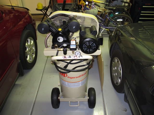

I just ordered an IR 20 gallon single stage compressor for general purpose use. Wanted something quiet with a small foot print that operated on 120 Volts.

The Garage Mate. http://www.ingersollrandproducts.com/IS/Product.aspx-am_en-12949
Originally Posted By: SIXSPEED
I got the IR Garage Mate today ... very nice compressor ... and very heavy too for a 20 gallon.
