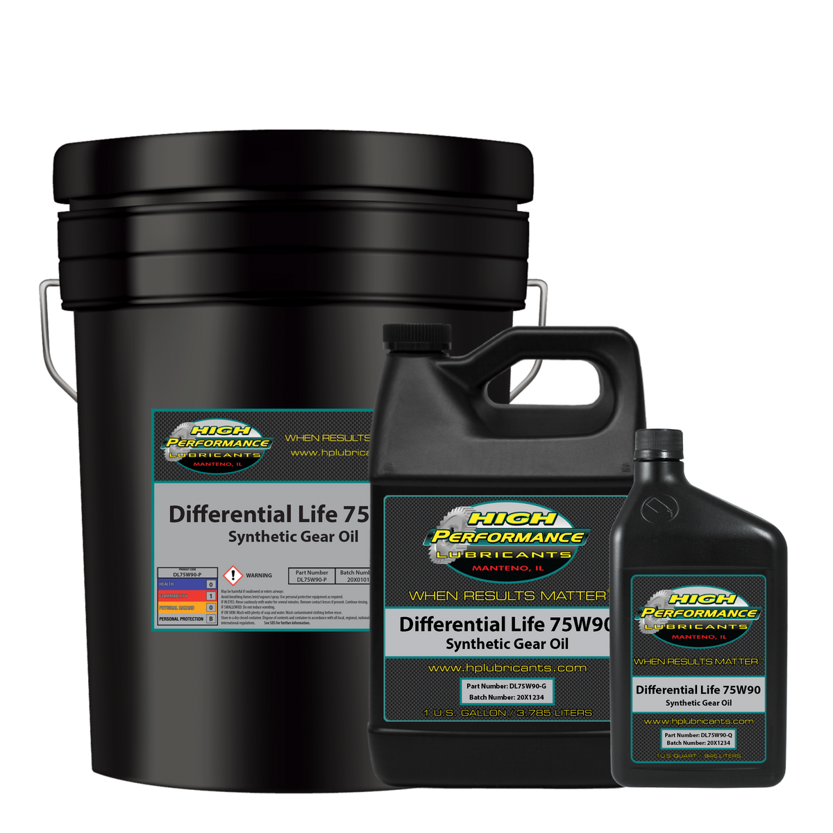

For your transfer case oil change, which takes about 1.6 quarts, your oil options are insanely priced Toyota 75W at $80/quart, Ravenol 75W at $20/quart, or, my recommendation; HPL 75W at $16/quart.
It’s not listed here, but if you call them, they’ve got it.
https://www.advlubrication.com/collections/automotive-lubricants/products/differential-life
Don’t forget the BITOG15 discount code for 15% off.
