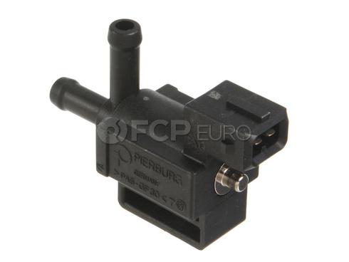

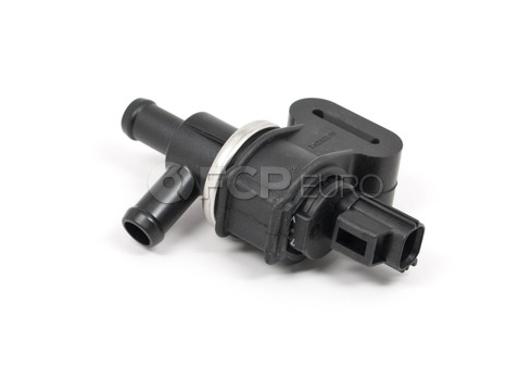

3. The SOV has much larger dia. tubing than the PV, to minimize pressure drop and flow resistance.
SOV:
PV:
