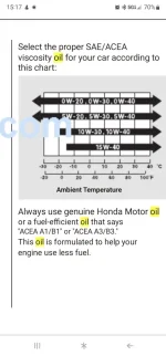

Dec 26, 2005
22,918
Upper Midwest
What about it?
The concept of a "euro" oil is somewhat changed these days although it still generally represents an HT/HS on the high side for a given grade. This gives more protection from wear than an oil with a lower HT/HS. But I'd say the biggest advantage is that most European approvals have higher oxidation resistance standards, as well as higher standards for deposit control and things like ring sticking. Except for a small reduction in fuel economy there are valid reasons for that recommendation and they are all positive.
