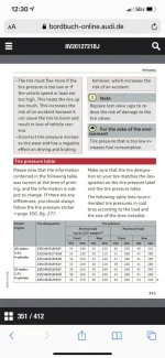

OK guys. I come to you hat in hand, to say that I have screwed up. I had seen in the owners manual a few weeks ago, apparently at a quick glance, that the manual says "The correct tire pressure for tires mounted at the factory is indicated on the label". The label being the door placard. If I had read further I would have seen "Use the tire pressure specified for a normal vehicle load when the vehicle is partially loaded > table on page 351". Looking at that table now, I see for my S3 sedan with 225/40 R18 92Y normal load (2/3 people) front pressure of 38 and rear of 35. So I can lower the pressure a little.
Again, thanks to all who posted. I feel a bit like a moron for coming here to ask about the pressure when it was given to me in the manual, if I had just looked a little further.
Oh well. It's not my first and probably won't be my last goof up.
No worries at all. It is something that is somewhat peculiar to Audi. Most brands only have one specified pressure.

Look in the owners manual, it will usually have pressures for a vehicle with no cargo and 1-2 people and pressures for a full load. The pressure on the door jamb is only the full load specs.
For example my car is 45 front , 41 rear on the sticker but in the manual it's 39f, 35r for regular load.
