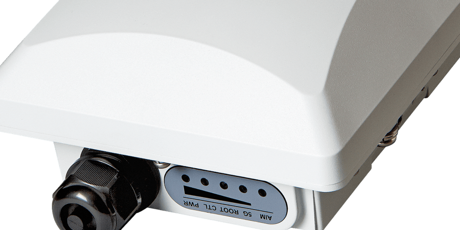

So I had a chance to get a TP-Link CPE210 antenna. It’s supposed to use Qualcomm Atheros Enterprise chipsets fwiw, and was available in 2.4GHz version because I was concerned about a very tall tree in the LOS.
I set it up, that’s a little clunky because you need to set a static Ethernet IP address then log into the unit via a browser, which is slow.
The setup I have is router-powerline Ethernet- CPE210 Antenna.
First I stuck it in my kitchen window, essentially beaming into my neighbors house. This is generally the direction I need it to go to get to my other property, which is diagonally rearward off the rear-side of my home if that makes any sense. The kitchen window is on the right side of the house to face the other building.
About 25’ away and outside of the antenna’s polarization, I still got signal. I could run a speedtest.
Much slower than my router WiFi, but that is ok if it worked.
Then I walked to the other property and stood directly in front of the building. I maintained connectivity to the antenna, though no throughput.
As you can see it claims a decent signal strength, but nothing transmits.
Then I moved it from my kitchen window to my attic dormer window, also facing in the right direction.
Signal strength looked the same, and still no web or speedtest.
So is this just because I was running this as an access point and so this antenna was on one end, my phone on the other? Is the bottleneck my phone? Is it that the phone can see/receive, but can’t transmit? It needs a stronger output to send data?
I can get another, these are cheap, and set up in client mode. Would this result Point to the fact that the WiFi user devices can’t send a strong enough signal?
Maybe I need to operate like a client vs access point?? I think that’s how the ubiquiti units do it.
