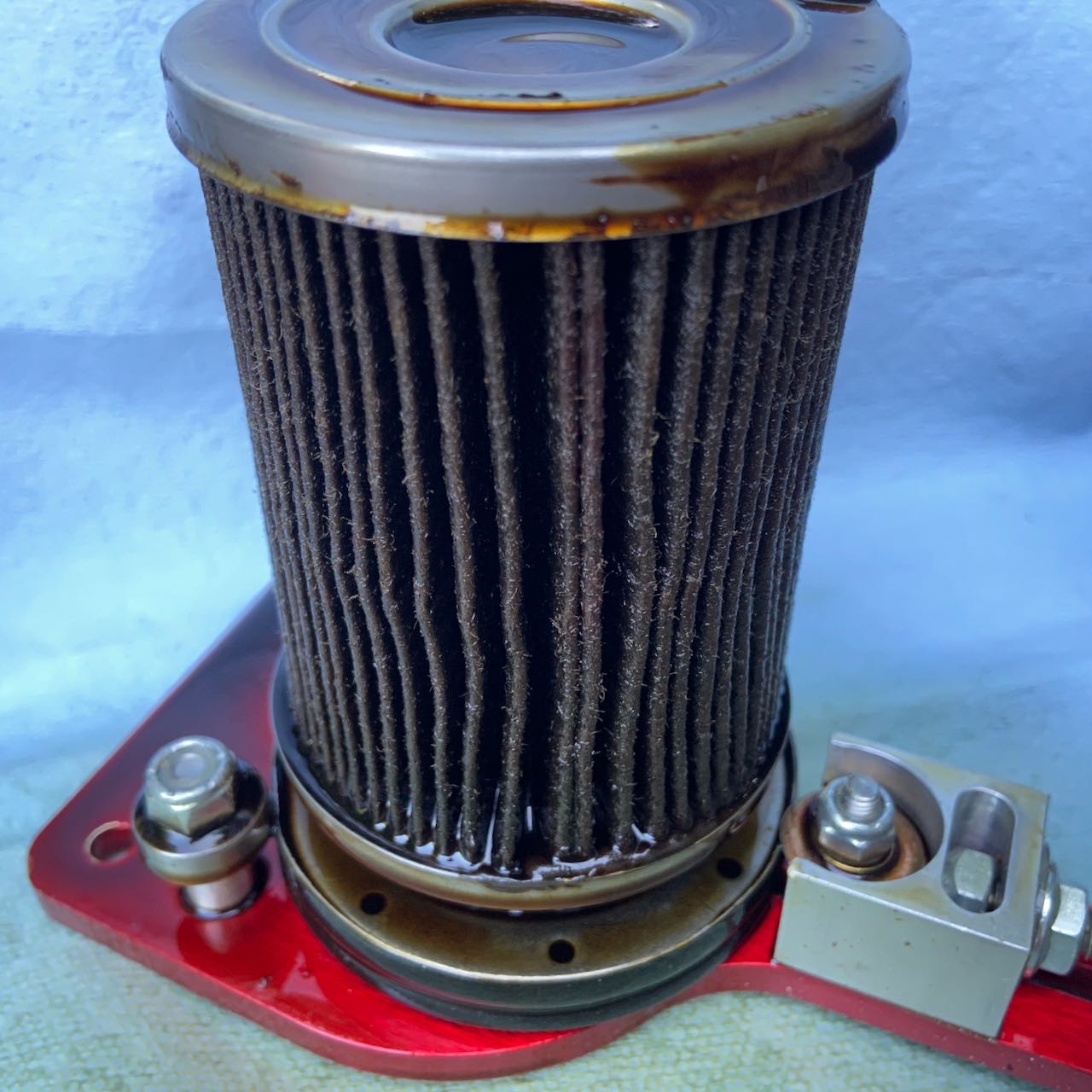

[Cut Open] Mobil 1 M1-209 (5267 miles)

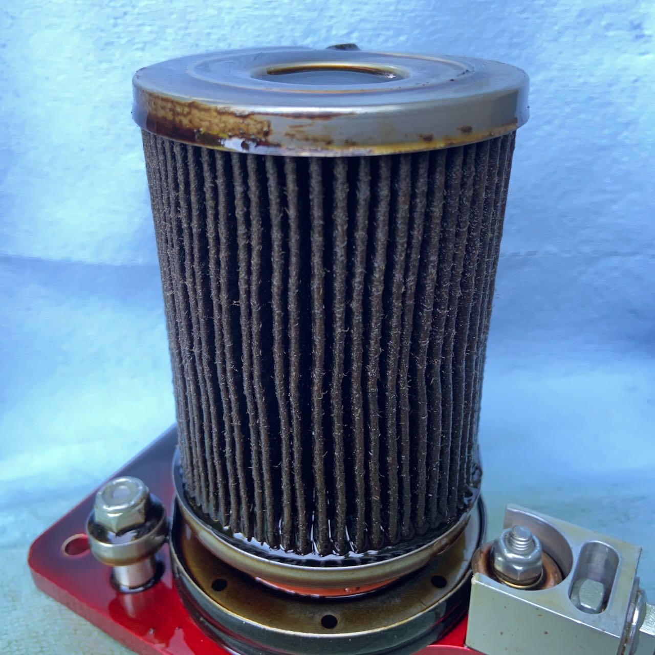

Dem thar pleats got some beef on them for sure LOL Looks very good as one would expect from a Mobil 1 oil filter. Thank you for you very good work here man.
While not cheap, Mobil 1 is a high quality filter. But we already knew that. They should make the Mobil 1 filters so they cannot be removed until at least 10K miles.

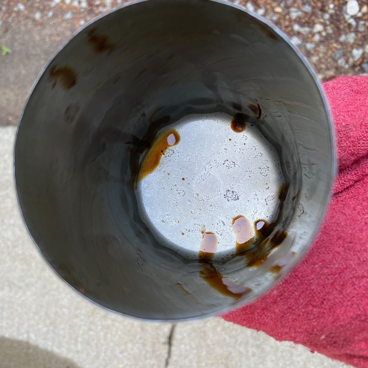

Champ labs non-ecore. Always the best. Never ever ever ha problems with them. Man that oil looks dirty for 5K miles. That's what my Wife's Subaru's oil looked like at 10K across winter. Was a solvent put in prior to this OC? Thanks - Ken
Originally Posted by 2015_PSD
images no worky
The image hosting site has trackers and my security blocked them and the images as well. I temporarily disabled them to see, but turned them back on.
Originally Posted by bullwinkle

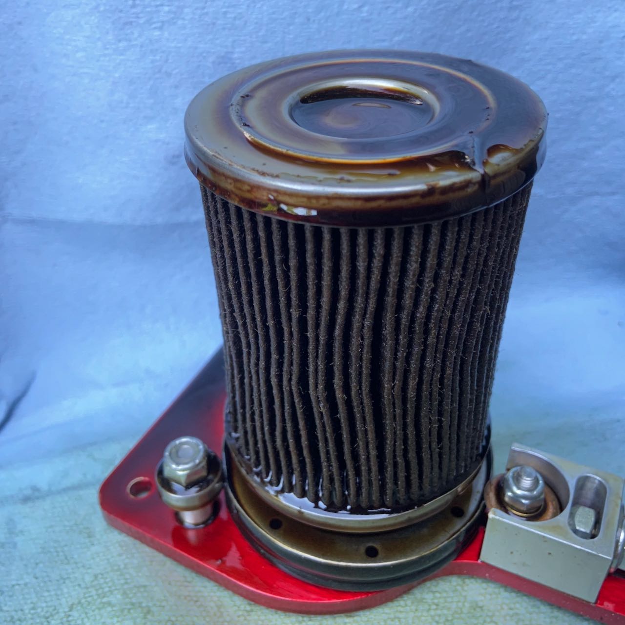

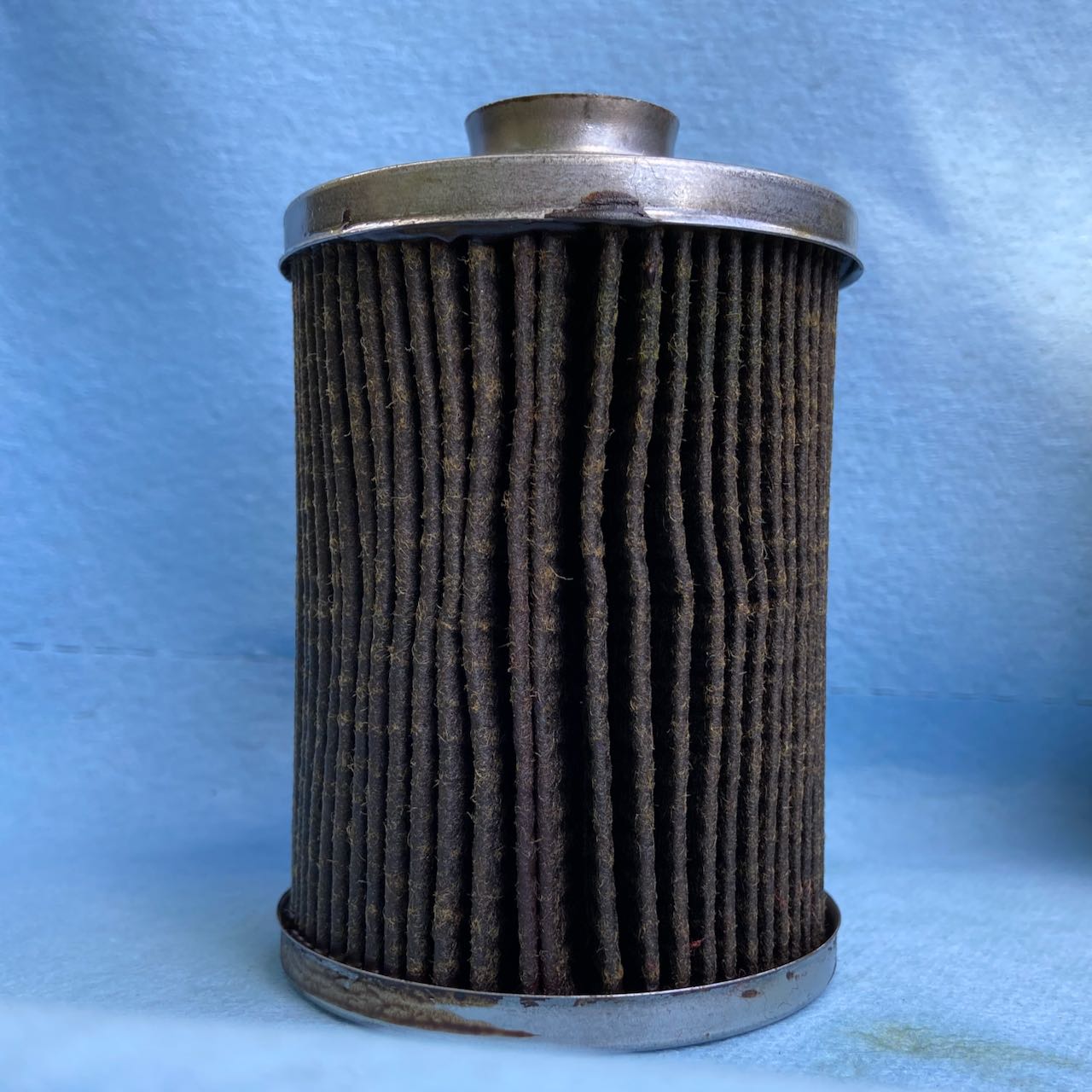

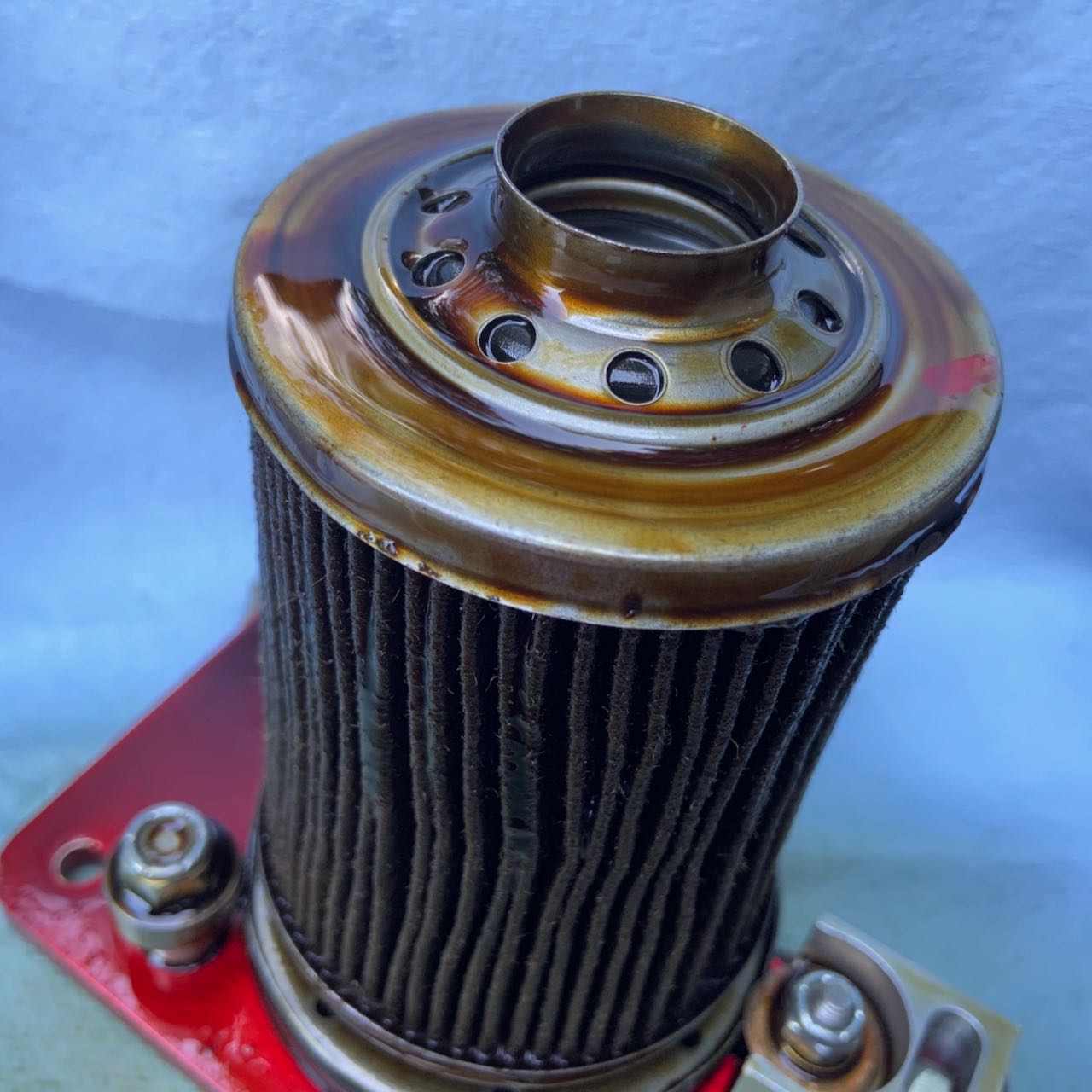

Is it an optical illusion, or is the media pinched in at the center a little? Looks like an hourglass? If so, that's new for an M1 in my experience.
Little of both, it's definitely deformed and a bit wavy in the middle, but not as bad as the pictures look.

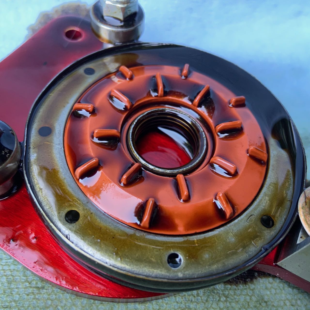

Originally Posted by BlueOvalFitter
DR, does the center tube have holes in it, or louvers?
Louvers
Originally Posted by 53' Stude
Looks like it did the job. Thanks for c&p Robert smile
You're welcome of course, it did do the job. Worth mention that it was in service for about 18mths and is an older filter, Oil was 5/30 EPHM.
