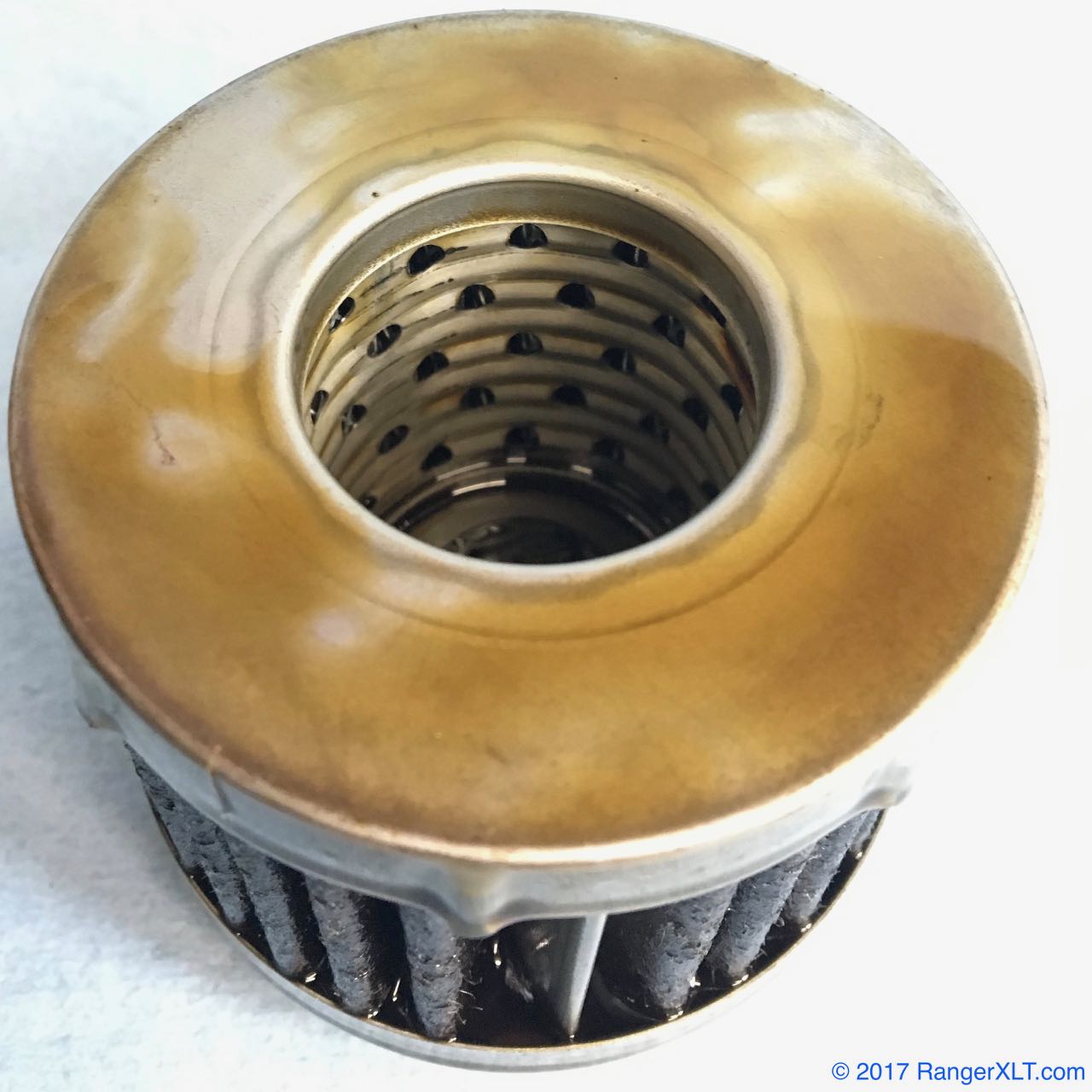

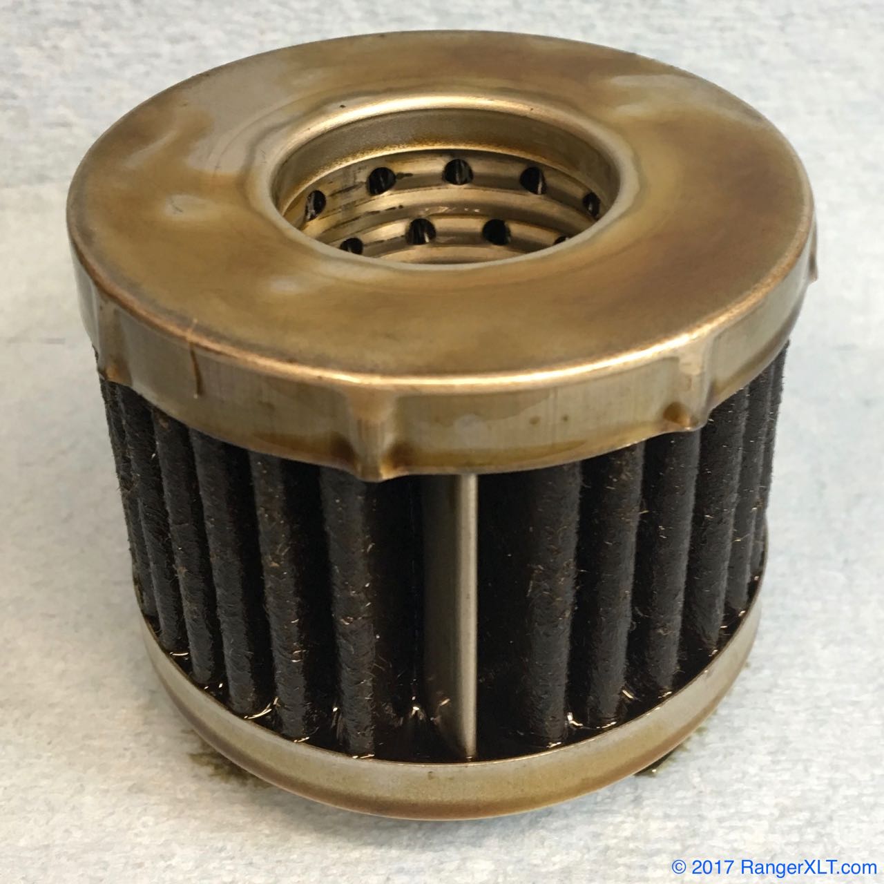

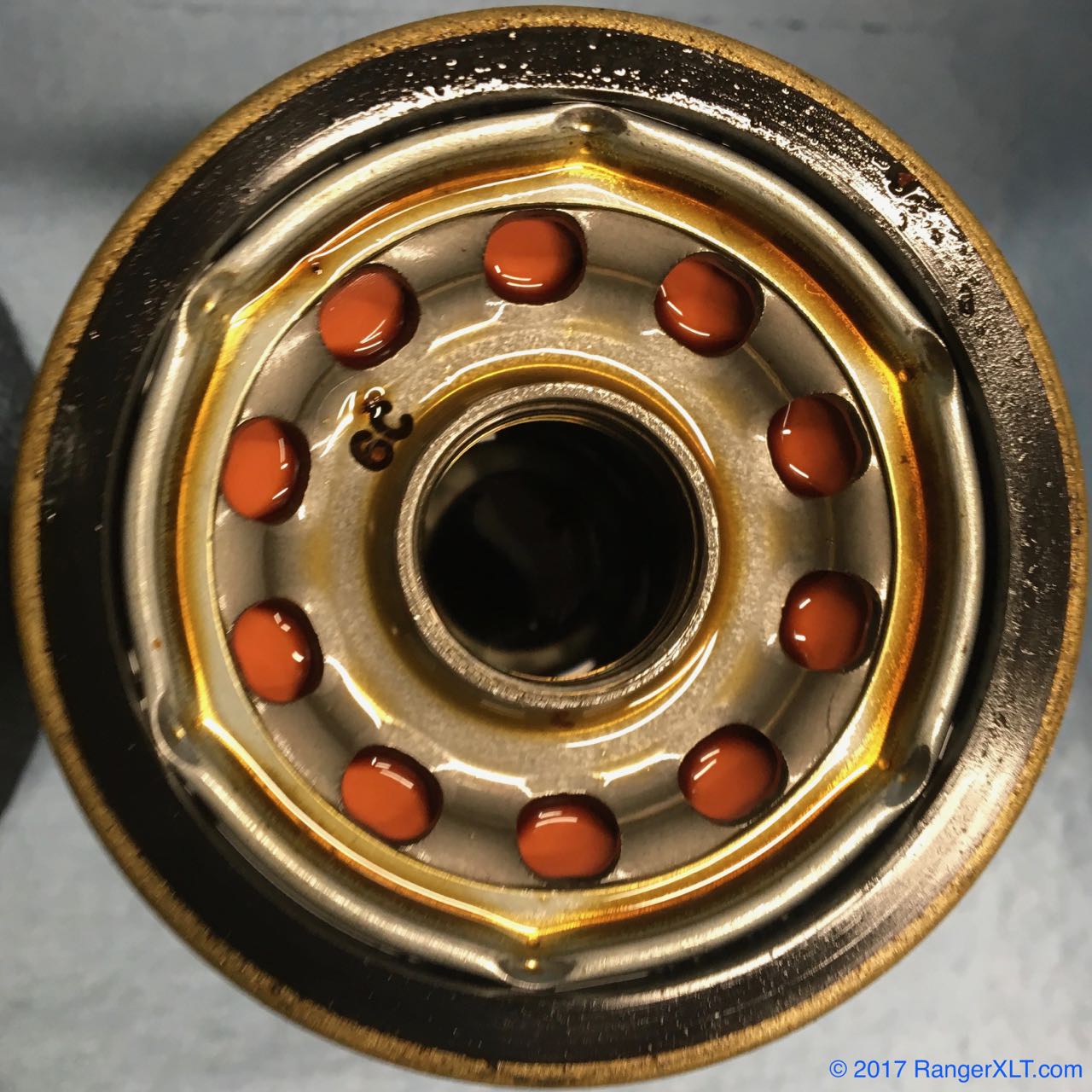

[Cut Open] Fram XG4967 - 10,452 mi

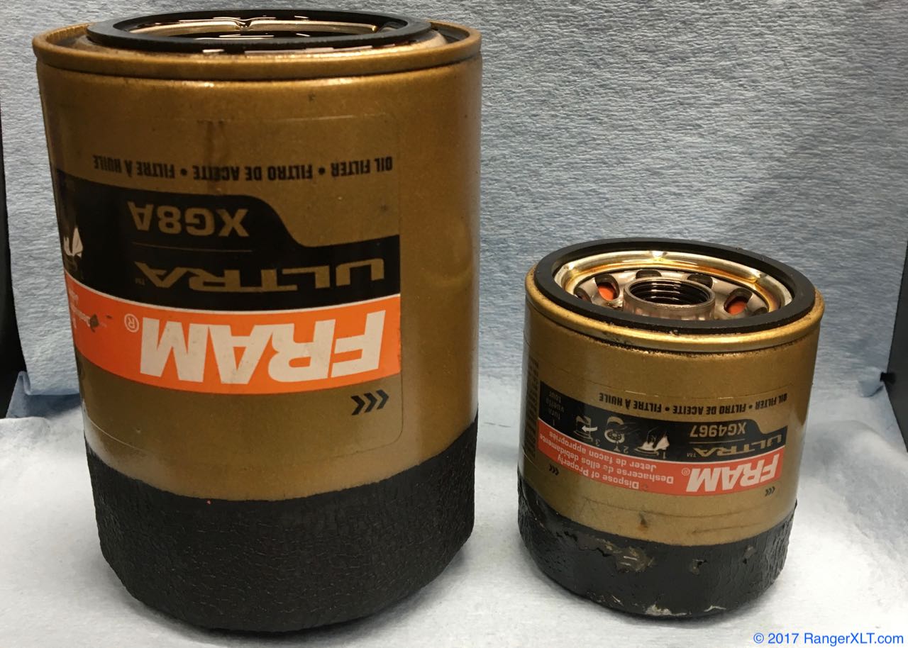

Nice! I put one of those on my echo. 11,000kms on it so far. Another 5k or so to go. Does that XG8A have the same size gasket? That would be a lifetime filter on the echo!
Ain't has small as the 6607 smile That's got it beat for sure. Very good job here Robert. You add a lot of good information/work here.
Another boring FU (a good thing) at a substantial fci. The shorty 4967 is the SAE thread equivalent of the metric 6607. Not many cases in my observation where the longer but otherwise same specs 4386 and 7317 respectively won't fit too. Also noticed the addition to the corner of the pics. smile2 Thanks for c&p.

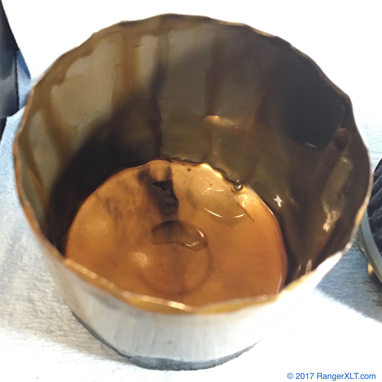

You are welcome of course. Filter has more gunk (note use of highly technical term) in the bottom than expected but is a solid piece for sure and the gunk is the cars fault not the filter...
I think the gasket is larger on the XG8A, I will check today, though I realize you are probably joking.

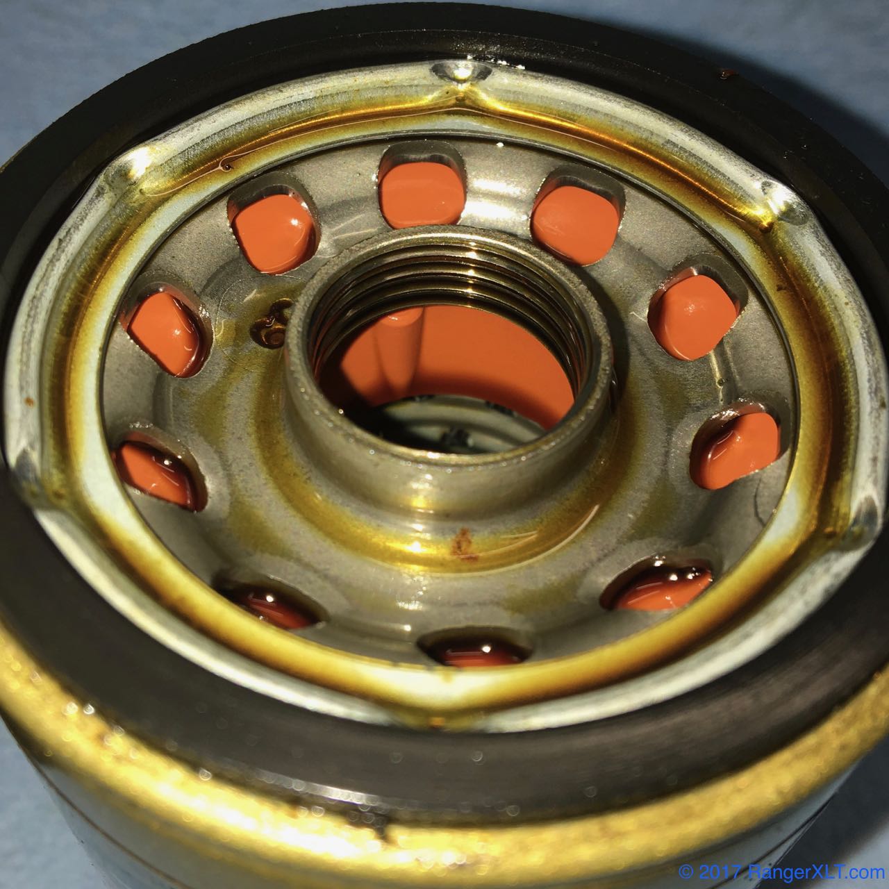

The oil holes are very smooth,no burrs. They look very precisionly cut.
Yep, typical Fram tapping plate, nicely made with no rough edges.
I was thinking that the 6607 was about the same size, I always get confused as to whether the Prius takes this on or the 6607 but the threads are different if that is the one I am thinking of... I do try to add value, My pictures are not coming out as well as I would like lately - need to try to fix that... Thank You though.

... Does that XG8A have the same size gasket? That would be a lifetime filter on the echo!
No, from the Fram site: XG4967- 2.118/2.438 XG8- 2.422/2.797 The inner diameter of the XG8 is right at the outer diameter of the XG4967. It is possible they could interchange, depending on the size of the mount on the vehicle (and enough space for the filter). Bypass is close (12 PSI on the XG8, 14 PSI on the XG4967).

Every Fram I have seen has very sharp inlet holes, usually with small burs. Just don't understand the rose colored glasses. It's a product made by a company, what it is, it is. They have different geometry that avoids cutting the adbv, although some have impressions of the holes in them. The 4967 has a wide land for the adbv to seal on, others models don't, like the 3614. IMHO The other thing easily seen here are the nubs on the end cap. All the oil flow has to go in that narrow gap the nubs provide. I would say that is more restrictive looking than inlet holes, just by eye. But it's surely calculated by the company, like the inlet holes. No one talks about the small gap for oil flow though on these filters.
Every filter I've cut open, or seen cut open here, regardless of brand, has what looks like a narrow gap betweem the can and end cap. Also, cutting the can with a cutting tool can roll the can edge and make the can look smaller in ID than actual. "Nubs" on the end cap actually make it possible to increase that gap and still keep the element centered in the can. Keeping an even gap also helps ensure the oil flow distribution into the element is evened out. Nothing wrong with having nubs, it's a plus to the design IMO.
I may look for the cut open 3614 I had in the garage and measure the diameters. Talk is great but pics and numbers better. Beaten down fiber nubs don't center so great. End cap gap is as big a topic to oil flow as inlet hole size or louvers. Never have seen anyone actually calculate it. One guy claims small gap destroyed his engine or something like that. Lot of things could be measured and posted as actual information, instead of arguing about it.
Arguing? ... it's called a technical discussion. Metal nubs don't wear down on metal end caps. Fiber nubs don't totally "wear down", they might deform slightly with mileage on the filter, but it still doesn't change the flow area between the can and end cap.
