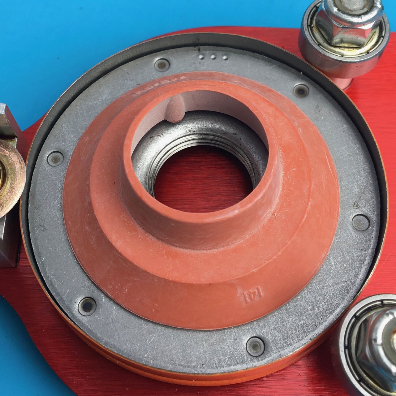

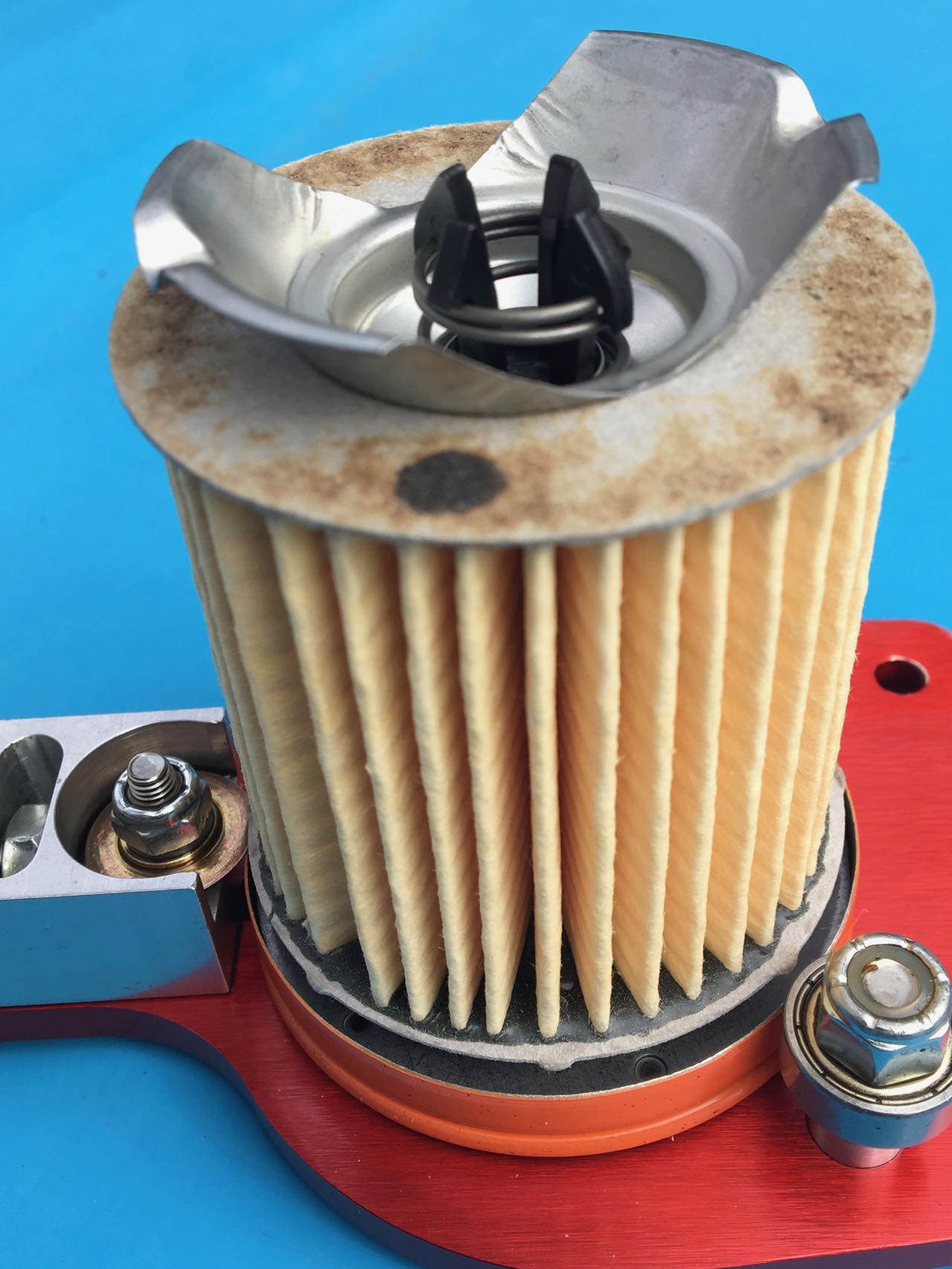

This is a great value for cost filter, especially with the silicon ADBV. I just purchased a PH4967 today that also has the new updated ADBV. I really like that Fram is adapting to the market and adjusting the construction of even their entry level filter to provide protection for the longer drain intervals on newer cars. You no longer have to pay the price premium for a TG just to get a silicon ADBV. I really like that because in a lot of cases a PH series filter is more than adequate especially with the silicon ADBV. Nice work Fram and thanks for cutting this filter for us.

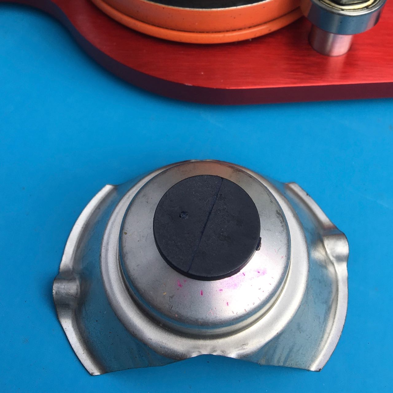

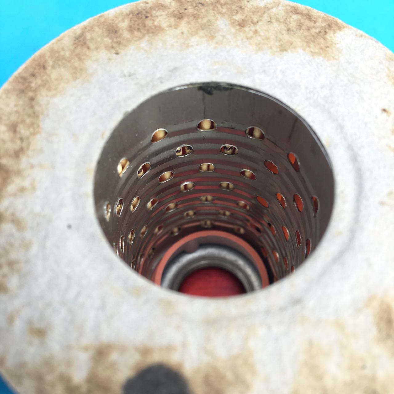

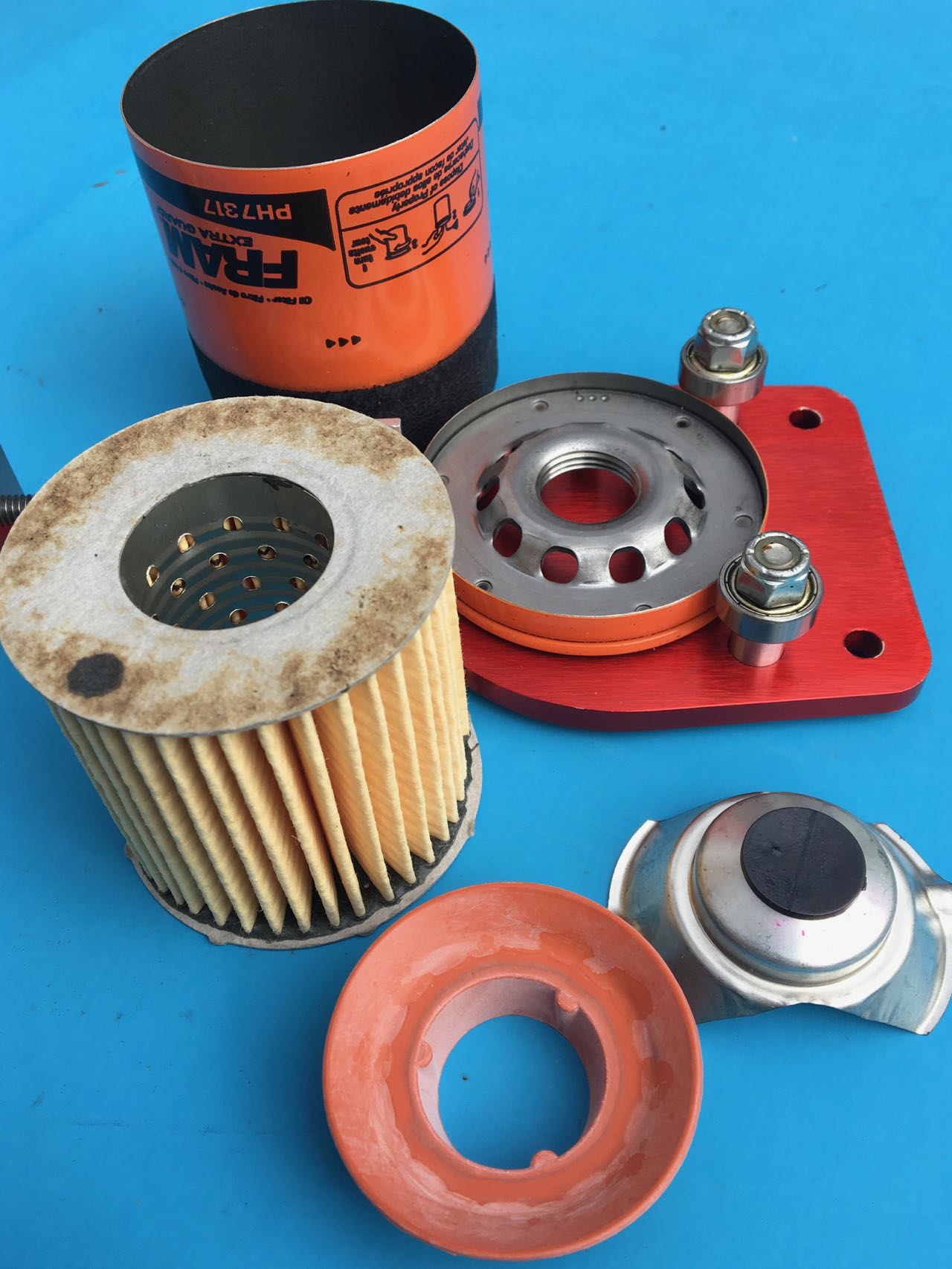

Bottom end cap looks different. Other ones have points and are not round. There appears to be some tiny nubs, maybe this model has it that way. Wonder how tight it fits in the can.

Car51, SF and Jimmy (as well as anyone else that thanked me for the C&P that I missed) you are welcome of course. Nothing to complain about here for $3.77. The center tube looks more accurately centered that we used to see on the Honeywell IIRC (it doesn’t much matter that leaf spring and ADBV seal it anyway) The nubs on the base plate seem about right from my memory of Honeywells, I will take a closer look tomorrow... The blade on my cutter is dull (and not the right one) so it is possible I suppose that the nubs got mashed a little when cutting apart.
