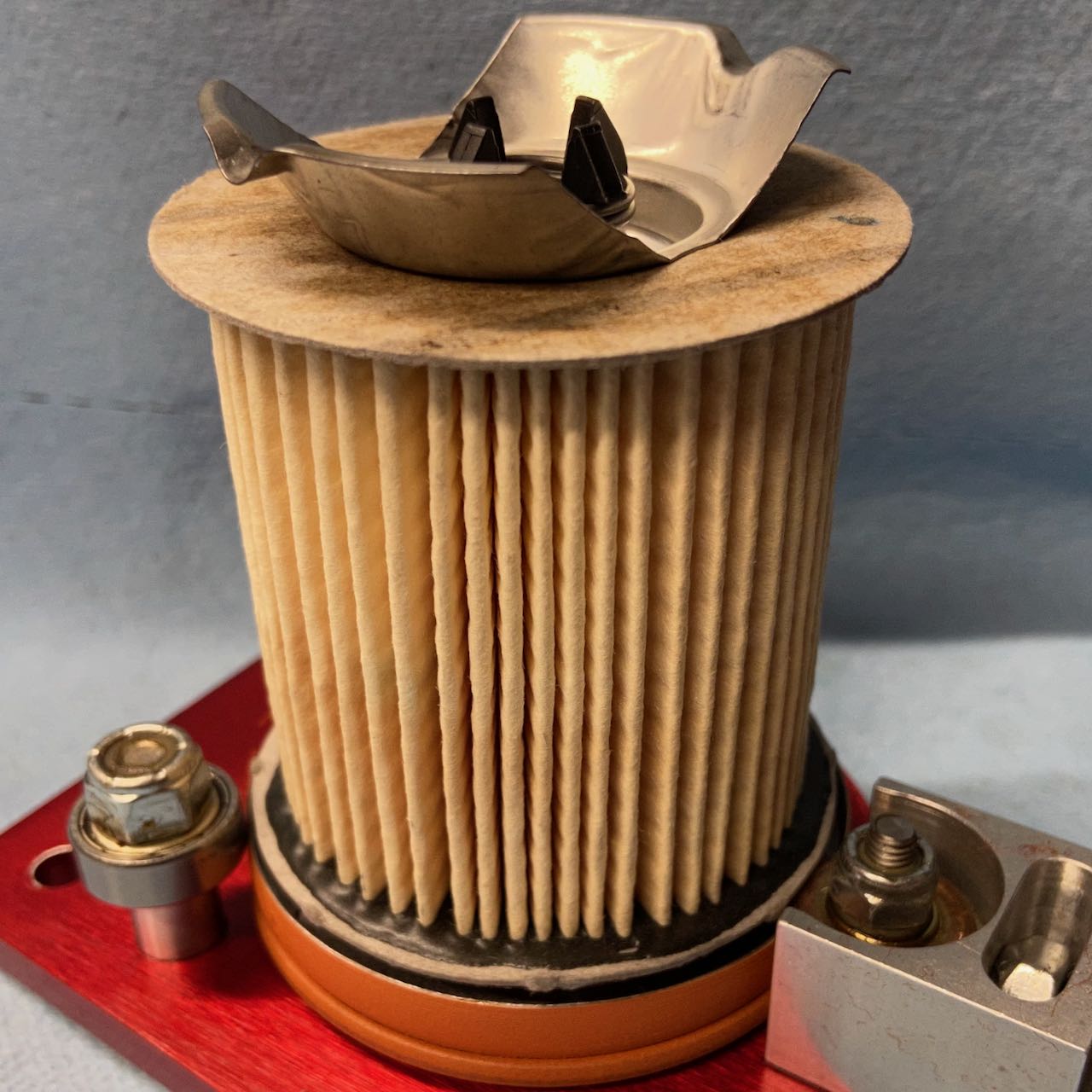

Box says 99% efficient, but no micron size listed. Fram's website says 98%+ >20u. Nice photos. thumbsup
Seemingly packed full of filter media which does correlate with Fram stating this filter has 20 percent more filter media added. Very, very good job Robert. Thank you very much for doing this and the other filter cut and open.
I've got a cut tough guard, I'll try to remember count the pleats on this, the TG is 43 IIRC, I'll double check though. Thank you and you're welcome of course.

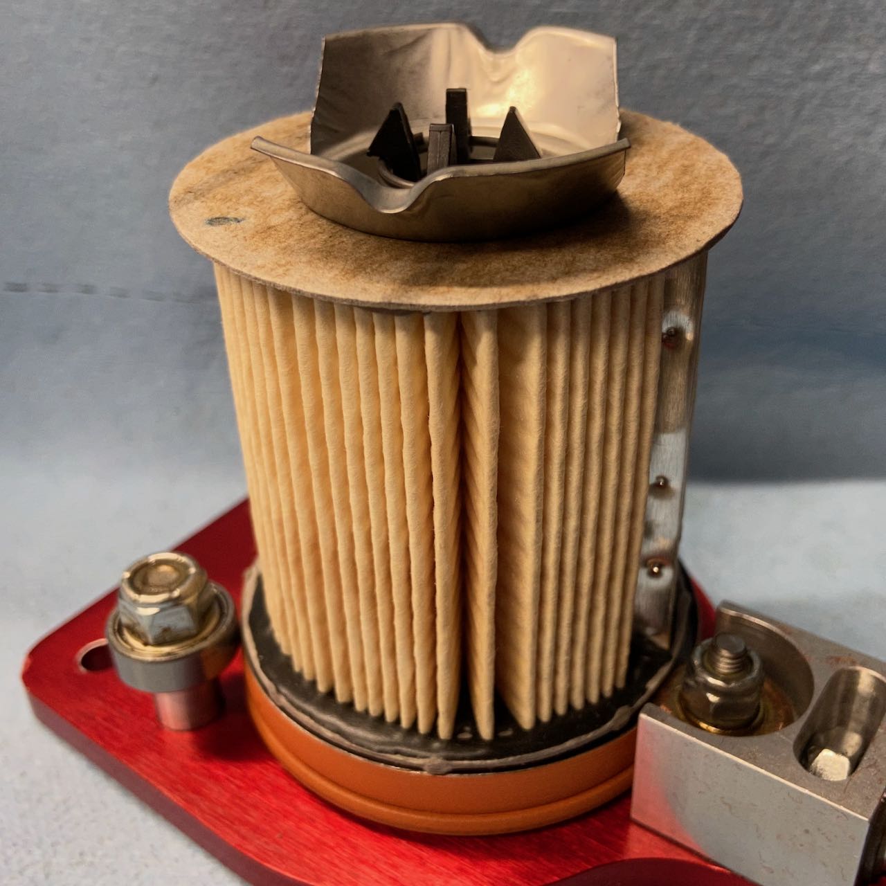

Definitely a cut above an EG, Looks like a TG with a metal seam clamp. So arguably a little better than TG. You're welcome of course.
Originally Posted by slacktide_bitog
Thank you for the cut and post thumbsup Looks just like the A02 with the metal seam smile
You're welcome. Yup, the seam clamp like A02.

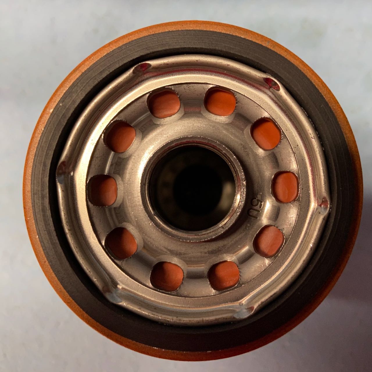

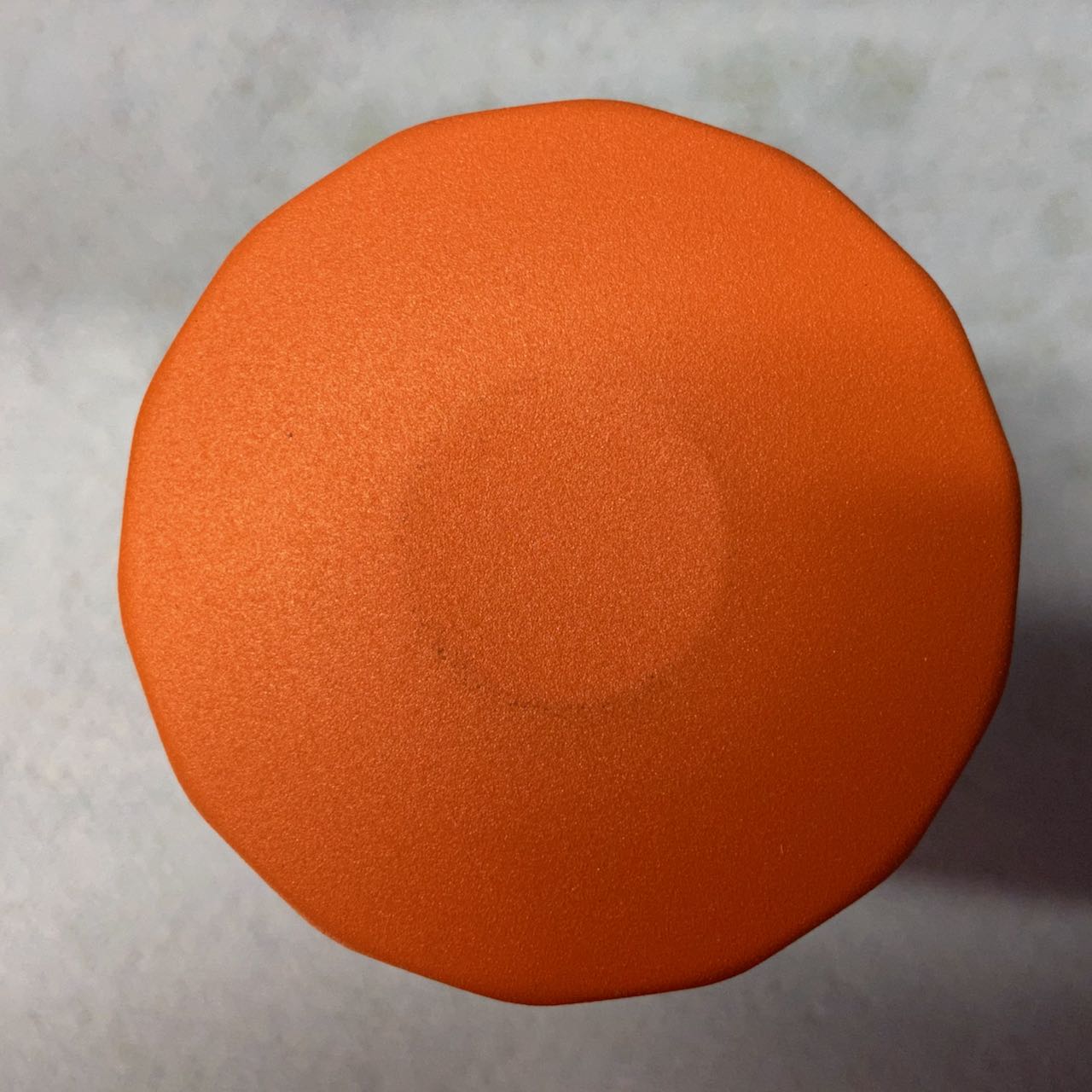

Curious the metal seam clamp the TG doesn't have, yet same mileage recommendation. Other things I noticed. The tapping plate holes look slightly different than I recall, I'll have to check is this is an optical illusion or faulty memory or if they actually differ. The center of the dome end of the can is slightly concave unlike other FRAMs, The coating is not rubbery like on the end of EG/TG/XG. I actually like it much better and a cap wrench should fit without issues.

You should read a bit further along. The Titanium isn't relevant to this thread, but the FF does in fact have more media in it than a TG, TG also does not have a seam clamp. So you are wrong that this is a repackaged TG, unless you want to argue the that they changed the TG at the same time, in which case I'm gonna need you to go buy one, cut it open and post pictures.

I think you missed my point. The Force has a metal seam clamp and more pleats than the TG. I don't care what a phone drone says, until someone cuts a TG7317 apart that has a metal seam clamp and the same pleat count they are not the same period. I have them both sitting here in front of me - NOT the same.
