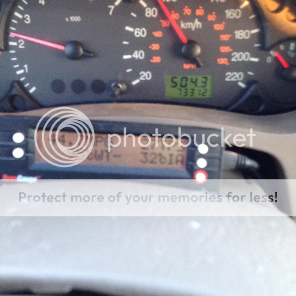

any one have any idea what the full operating temp is for a Duratec 2.0 with the MTX-75 manual trans? I still have heat, but with my scangauge I can watch the coolant temp go from 155-170 and back to the 155-165 range. This is also with the defroster on because of the recent rain/moisture around. Curious if its possible that my thermostat may need to be replaced for being stuck open.

Also, my SG will never hit 180F. and I just noticed this recently... within the last week.
