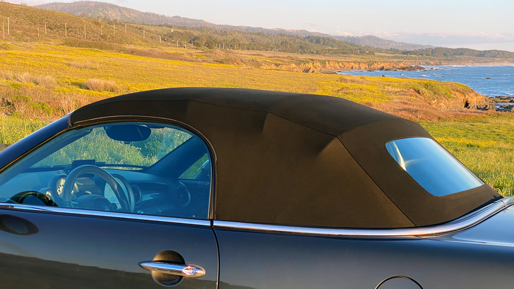

I love driving topless. Monepenny's top is in top shape. No wrinkles, sagging, no tearing or stretch marks. I don't see sun damage. The rear window is glass (heated). I clean the top regularly with 303 Convertible Top Cleaner and a horse hair brush. I apply 303 Fabric Guard every 3 months once the top is dry after a thorough cleaning. The top and folding mechanism are solidly made and don't resemble an umbrella.

Last pic shows the crinkles I mentioned.
As for frequent use and wear and tear, I don't think that's a concern. I haven't noticed any cracking on the inner rubber-like liner/coating. The mechanism has a bunch of lube points and I don't notice slop in the pivots despite the car's age.

This is the original top at 8 years old. It's not wrinkly from what I can see. No tears, fraying, loose stitching, or leaks. The first foot or so of the top is actually a cloth-covered hardtop that becomes a neat and clean-looking lid when the top is folded down. The vehicle is garaged at night but spends a good amount of time in the sun and by the ocean. To be fair, until I bought the vehicle two years ago it was probably stored in a garage for most of its life. The appearance of the top has not noticeably changed since I bought the car. The top comes down whenever possible.
I have found age and weather (primarily sun) exposure affect soft tops far more than folding.
The crinkles are typical, nothing to be concerned with.
