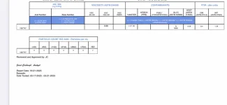

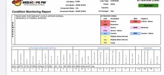

Chevron Supreme 5w30 3,000 miles Ford Escape 2.0L Ecoboost
Jun 11, 2014
571
VA
Here is a link to the VOA of this oil
This vehicle has 69,000 on it and is a commuter ~10 miles during the week with long drives on the weekends.

I have Castrol Edge HM 5w30 in the car now with a motorcraft filter. I'm thinking of trying a 10w30 next time to see if I can keep it in a 30 weight through 3,000.

How do those “Tin” levels look?🤔
Viscosity dropped from 10.19 to 8.88 cSt. Iron and Tin are both a little high, especially for only 3000 miles.
Not bad.. are you going to sample a 10w30 and what brand are you going to run in that weight?
Not sure. I’m considering QD full synthetic 10w30. I was to pull a sample of this Edge HM in there now at about 2800-2900 miles to decide if I should stay with that instead. That gives me time to shop before I have to change it.
