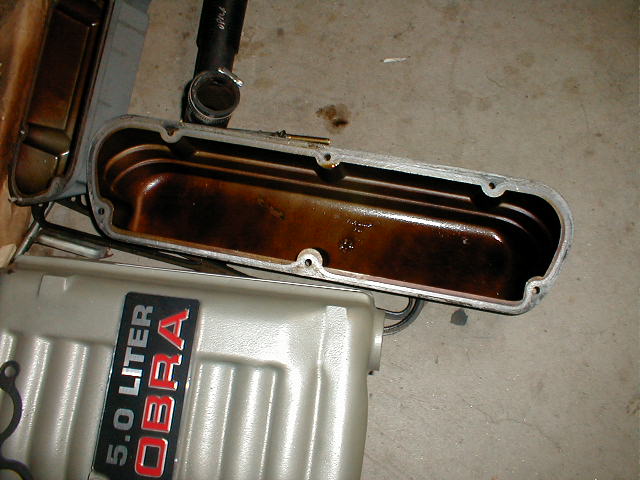

I have an 85 Ford LTD with a 94 Ford Mustang 5.0 engine installed. I recently changed cylinder heads with aftermarket ones (AFR). Long story short, my oil pressure dropped severely after the head swap. I'm down to 5 psi at hot idle and 35 at hot cruise. I made the mistake of not changing the oil before I started the engine, and I think some of the old head gasket crud got into the engine and got picked up by the oil pump pickup. The engine has about 140K on it and was fairly clean (see pic of valve cover below), so I can't think of anything else. I've changed the oil and filter twice since the swap (including using straight 40 weight oil) with no change in pressure. I also cut open the filter I used after first starting the engine and found no metal.  - I was recommended to this board by people on a Mustang board for a possible chemical cure to my problem. Dropping the oil pan is a $500 affair, so I'm open to any suggestions. I've heard good things about Auto-RX, but I think it would work too slowly for my purpose. Any ideas? Thanks, LTDScott
