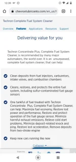

Does the additive manufacturer say that it does?
Yes. " Maximize fuel economy, Restore lost power and performance, Restore and protect operation of the fuel gauge sensor"
