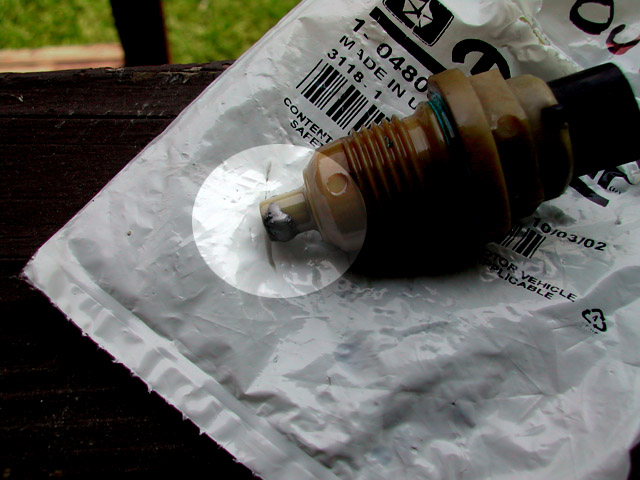

I'm curious: Have you ever had to do anything to the transmission? The input and output sensors are notorious for going bad, and I purchased two and put them in the trunk when I bought my 99 Chrysler 300M. Sure enough, two weeks ago at 63,000 miles the output sensor went. I put the car up on the ramps the next day and replaced both of them.
I actually don't consider this a major issue with the Chrysler transmission, and an early fluid change would probably ensure that the sensors last the life of the transmission. If you've gone 220,000 miles and only had to replace the sensors, that's excellent. If you've gone that many miles and not had to do anything, it's phenomenal.

On the transmission, when I changed the oil over to Amsoil at 30K, we did the tranny at the same time. Since then, it's had fluid and filter (the only FRAM filters I use are for the tranny and air cleaner) change every 50K with the Amsoil tranny fluid. I also had to replace the shift cable (column shift). It's never had an input sensor or an overhaul.
Changing the fluid at 30K and then every 50K is why you've never had to replace the input and output sensors. I never understood why they would go bad anyway until mine did and I pulled it out. The end was covered with the same sort of metal debris that the pan magnet is supposed to catch. When the builup gets too bad, the sensor can't work. I probably could have just cleaned this mess off and reinstalled the old sensor. I suspect changing the fluid once early in the transmission's life prevents this debris from continuing to build up on the sensor and thus it doesn't fail.
