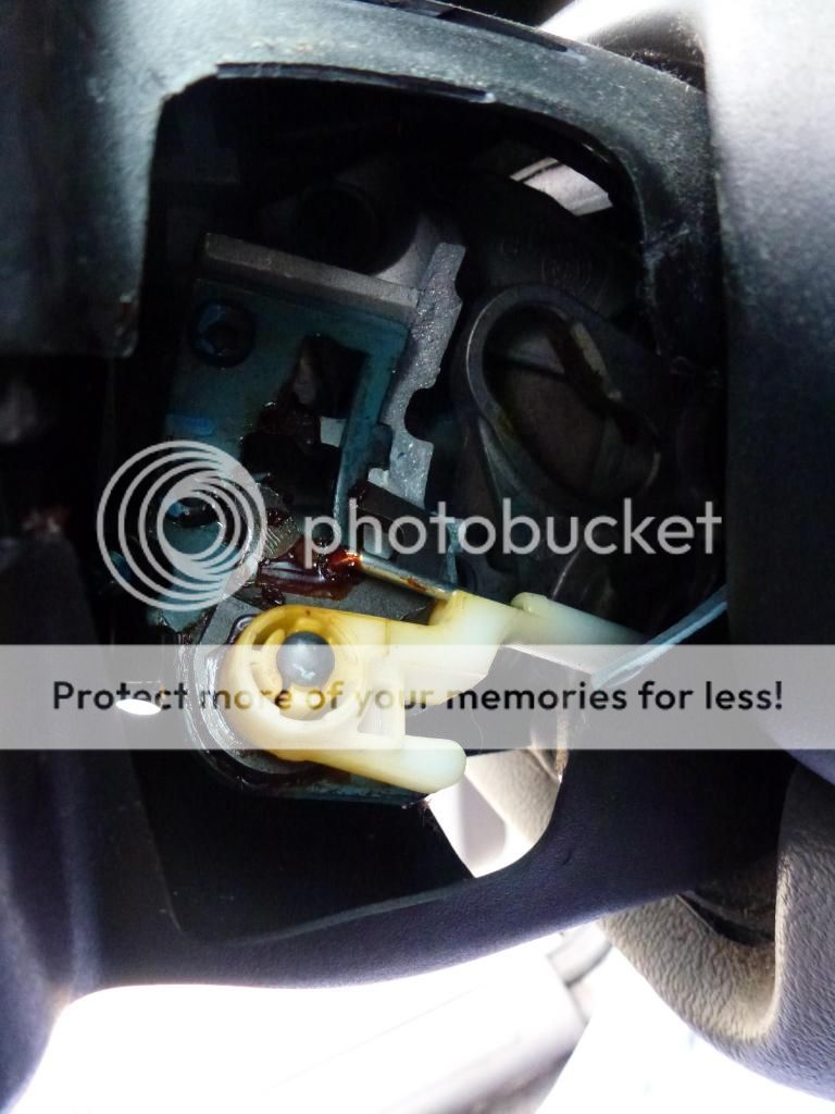

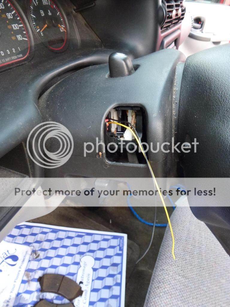

While I had a Pontiac Montana sitting where I was going to work on it waiting to order and receive wheel hubs assemblies....someone appears to have tried stealing the vehicle. I don't understand why they did what they did, specifically breaking the shift lever off. I can only guess that they were [censored] after failing to hot-wire and steal it so they broke stuff? How bad is this gonna be for repair? Just some reasonably priced parts or expensive entire assemblies? As I said they broke the shift lever and also the turn singnal lever, so It can't be driven or even started right now. Just trying to figure out what to do with it now.

If you've got comprehensive coverage, I'd file a insurance claim Just the turn/wiper stalk is touching $250 The shrouding shouldn't be too much, or find it in a pick and pull The gearshift is gonna be a tricky one. Get researching, and start looking for a replacement?

Sorry to see that.. those poor thieves had no idea the car wouldn't start without the key anyway! GM Passkey in effect. It might be easier/cheaper to try & find a new steering column for that instead.. But the gear & turn signal levers are easily obtainable... I'd look on ebay for the plastic pieces..

Yuck. Sorry. The pick n pull might be your best bet. You can relearn passkeys easily enough or reuse the old lock cylinder so the customer has one key. But the small stuff in steering columns gets pricey as said above.

I know on Ebay a shift lever is 19.99 that is the probably the easiest to fix out of all that damage.
