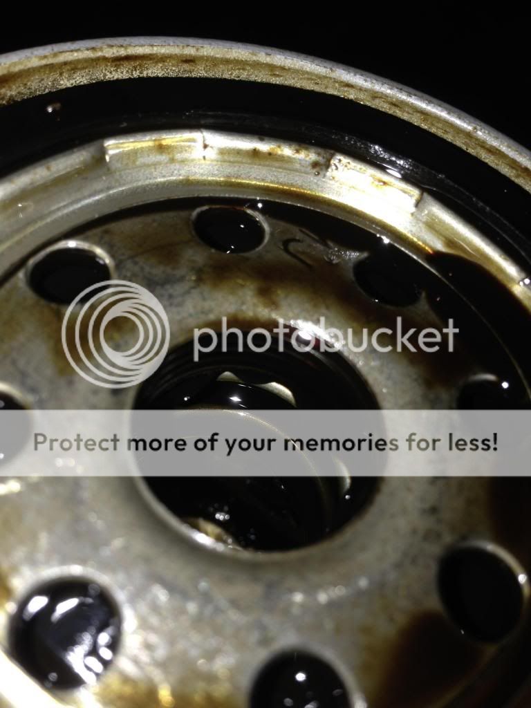

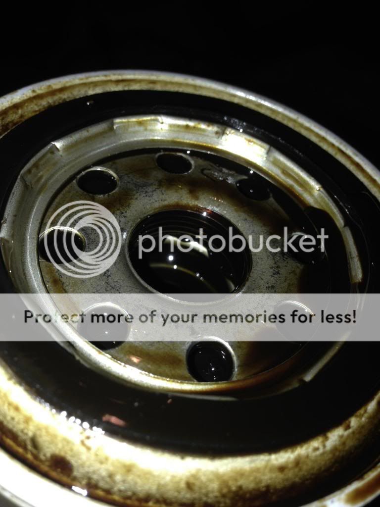

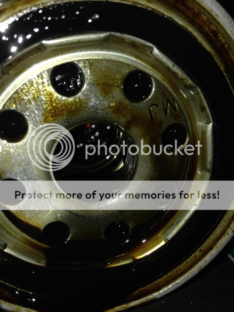

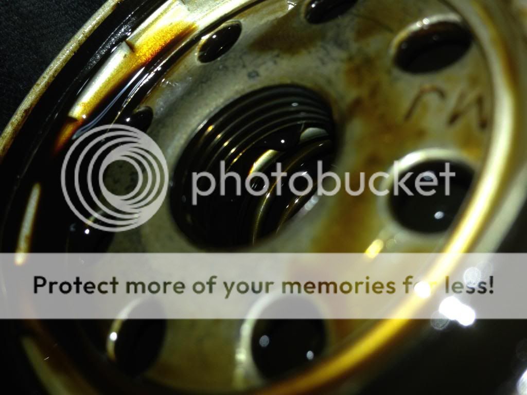

I changed the oil in the gf's mothers car tonight. This makes her brother (previous post) and mom's OCI with 11K on Castrol gtx and a proselect filter. There was a nasty divorce so the maintenance on their vehicles suffered since hes in the picture anymore. I'm trying to promote better vehicle maintenance and show them the difference and whats wrong.
Here are pics of another filter. While I haven't dissected it yet but if you look at the nitrile ADBV, it is not seated correctly is is fluted/wavy all the way around. Her car is now also on my OCI schedule. Like I said in the last post, these are good filters but not for extended OCIs. I refilled it with some leftovers 2.5qts VNG 5w20 and 2 qts M1 HM 5w20 with a puro classic and set the OCI at 3K. What came out was not pretty but seem ok and the dipstick was varnished pretty bad but was clean-ish. Enjoy the pics.

I can't tell what I'm supposed to be seeing as the "failure"?
What am I missing?
ADBV are suppose to be smooth and seated to make a seal. This one is not even or smooth and is fluted, therefore not doing its job as a ADBV.

Originally Posted By: volk06
What am I missing?
I'm aware of how an ADBV works, but I can't tell from your pics whether it is fluted and not sealing. How are others seeing what you're claiming in the pics?
I can't see much of the ADBV though the holes in the baseplate in these pics.
What am I missing?
Look right past the threads on the inside of the filter. Those aren't drops of oil but rather the wave from the ADBV.
