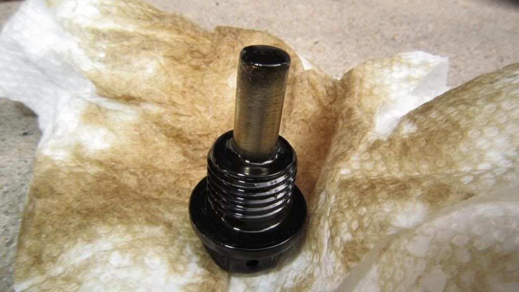

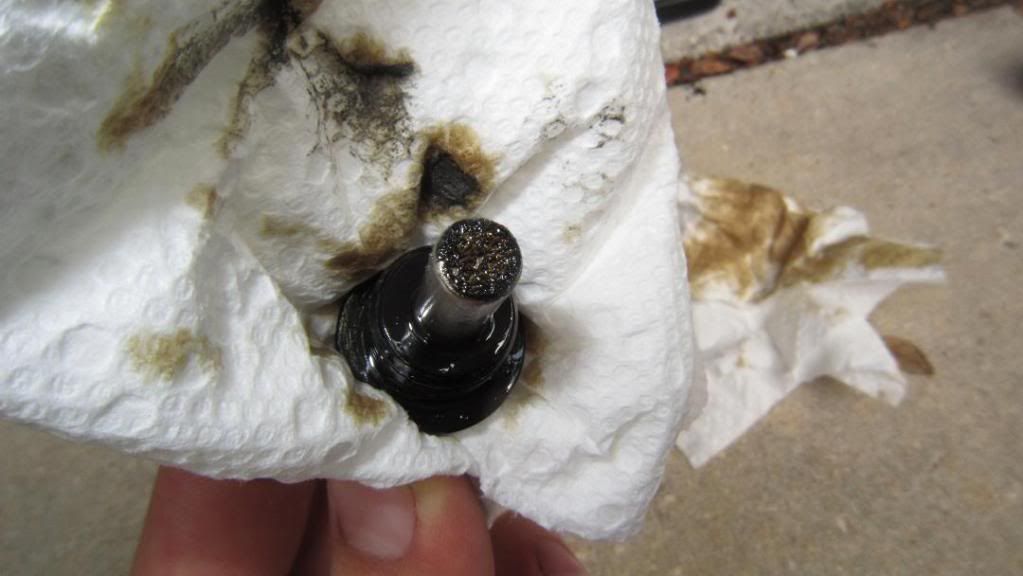

I hope so. It's an awesome little engine. Here's a few pics that i forgot to post in the OP. This is a Magnetic oil drain bolt. It always collects this amount of metal bits. They are so tiny that it looks like sludge but since it sticks to the magnet, it has to be metal shavings. NOTE: This is not an el cheapo bolt from autozone. This is an $80 high quality drain bolt. The set i bought came with a transmission bolt as well which collects EVEN MORE shavings.

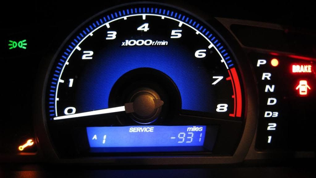

Here's some more info regarding the OLM on the Civic, or MM (Maintenance Minder) as Honda calls it. @ 15% oil life (this is when the maintenance light first comes on) mileage was 7,100 miles on the oil. @ 5% mileage was 7,801 @ 0% mileage was 8,211 Oil was finally sampled / drained with the meter @ -931 miles past 0% oil life, for a total of 9,148 miles on the oil.
