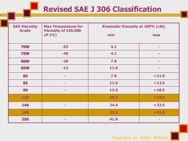

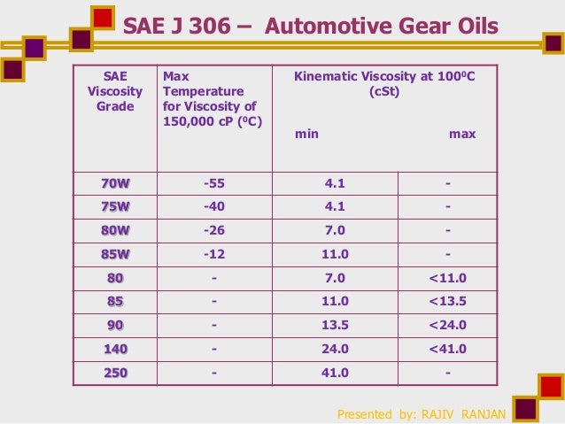

Affordable and Motul in the same sentence...never thought I would see that! Seriously, re-read what I posted. I've got a relatively new Tundra. Same specification. No need to overthink the differential oil. The 75W transfer case oil is an altogether different matter. 75W is a completely different SAE viscosity than 75W90. From another post in this section:
Originally Posted by Rollins
It was revised in 2005. http://www.ptplab.net/upfile/201402/13/094319180.pdf revision years 1998 revision 2005 revision Interesting what the OEM fluid visc. might have been...probably closer to the old upper limit of 24cSt...
Take a look at the SAE paper.

Forget that weight and just use a 75W-90 GL5 and go on about life. Most Toyota dealers will not even stock that product as they just will use whatever bulk 75W-90 they have on hand for servicing. I have yet to see a reported failure of using the 75W-90 in place of the 75W-85. As someone already mentioned, going 75W-90 will open up many other doors for a just as good product.
