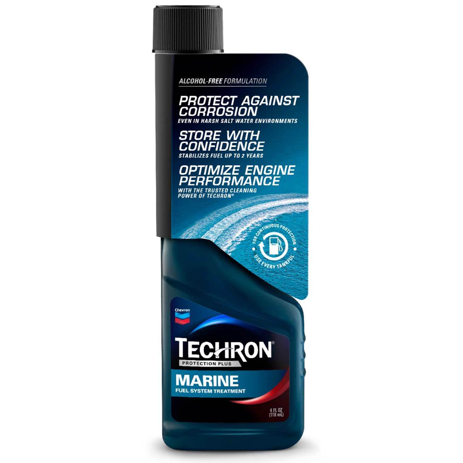

I don’t do any of that stuff - I do start them at least twice a month …
Have used Chevron Marine for many years - and for the last 6 years I have bought E0 for around a buck or less more
(depending on octane of E0)
