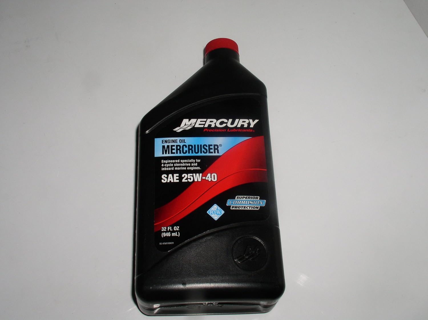

-Running her with Mercruiser 25w40 non synthetic oil
what do you think adding a MOS2 can in that engine? Can this affect my seal/gasket?
