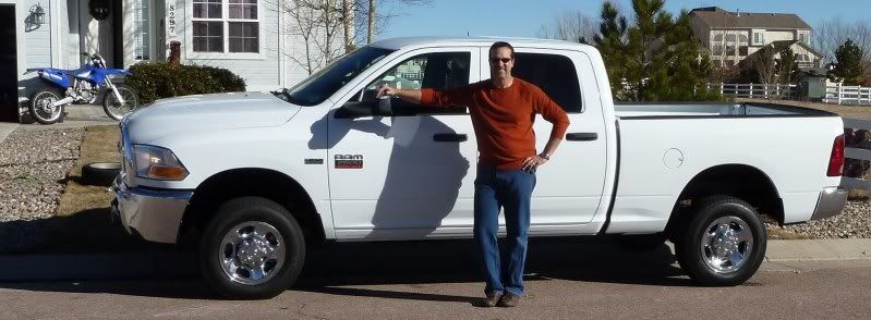

Here's my 2010 2500 Hemi. Current oil is whatever the dealer filled it with when I bought it used a month ago. Gonna run PP 5-30 and never look back! It has a 7+ qt sump so probly run it 6-8 months and 6-8,000 miles OCI and do a UOA.

Two reasons why I am using my Summer/Winter Plan..... 1. 20wt in the winter for better cold flow. (considering M1 0w20 or PP 0w20) 2. Nearly all my towing will be in the summer months, hence 30wt. (PP 5w30) My truck is two weeks old. At the 750 mile mark, I dumped the factory fill and poured in yellow bottle, 5w30.....and I will run that until April 1st. I suppose if I were to ponder the intent of Chrysler around this messaging, I would guess that we are to run a 20wt, unless towing heavily. Here's my 2500 Hemi

Nice truck! Great color choice too. How do U like that big Cummings hood?
