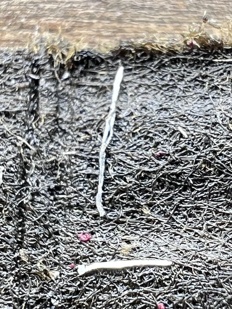

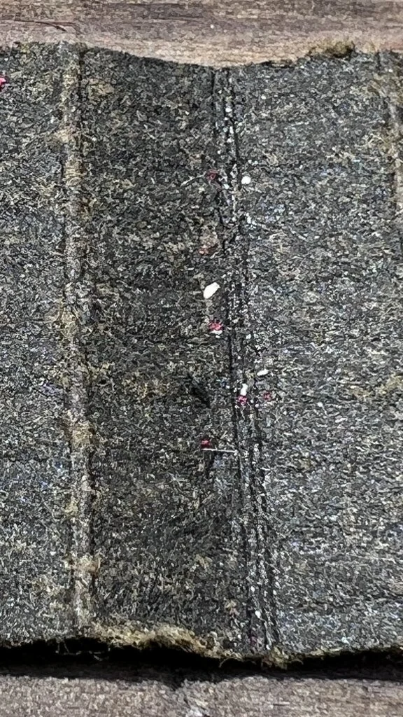

The factory oil filter is the first factory filter I have ever removed that wasn't grossly over tightened. Nice work GM. The debris in the filter is a bit shocking, metal and sealant mostly. The factory filter was a PF66 and was well constructed, but is really small.
Note the debris in the filter element:
