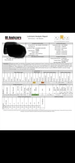

Just got my latest oil change analysis back. Things are looking good.😎 Titanium must be part of the ad pack from Schaeffer now? I haven't seen titanium in the past in the 0W-20 oil like this.

See my latest oil analysis report I just posted on here. So Schaeffer is putting this much titanium in the 0W-20 ad pack? Is this a new thing? Oil looks like it's doing a great job!😎👍 I've never seen titanium at levels like this in Schaeffer 0W-20 so that's why I'm asking.

Titanium? Interesting never seen that Schaeffer oil.
Seems like a recent thing. My old 2014 Mazda 3 with Schaeffer 0W-20 didn't have it. When I dumped the factory fill Idemitsu 0W-20 there was no titanium so I'm thinking it's gotta be something changed in the ad pack? New formulation?🤷‍♂️
I'm guessing new formula. I've used them for years, never seen it until now.

Yes that would be interesting.
I heard back from my Schaeffer sales rep and he claims no titanium in the ad pack.😳 Did not hear back from Schaeffer HQ yet though. Very strange that titanium would go from 0 on factory fill to 20-30ppm as soon as I switched to Schaeffer...🤷‍♂️ Coincidence? Not sure on that one.🤦🤔
I'd personally use another UOA company and see what they say.

...so I talked to one on the heads of the tech dept and the head of the lab. Titanium was indeed part of the ad pack on passenger car engines oils, briefly, the new SP formulation dos not have titanium in it.
Thanks that confirms what I was told by corporate. My sales rep was unaware of this.
