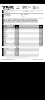

Wanted to see how Amsoil SS 5W30 did in my hard driving 1.6L Turbo in Tampa Summer. Moved here 7 months ago. 4100 miles of traffic, heat and hard Turbo use. Seem to be better than the recommended 0W20. I wanted a higher HTHS. Will go the KIA recommended 6k.

Looks great. I'd stick with the 30 grade... might want to even try a euro 30 grade once for comparison. No need for 20 grade!

I also use AMSOIL in our RAM 1500 5.7 HEMI, the exact SS 5W-30 you're running. Looking at the cSt @ 100C it seems like it water down to a 5W-20, most likely due to fuel dilution. AMSOIL SS 0W-40 would also be a good choice. However, QS Euro 5W-40 is excellent stuff for a T-GDI engine. If it was a larger displacement, I would have said Mobil 1 FS 0W-40 or 5W-40. Anyway, that QS Euro 5W-40 is basically a thick 5W-30, so it will give you some room for fuel dilution.

Fuel didn't seem to an issue. I ran her hard so going to run same for 6k and see what she brings back. If still thin will move to Amsoil 40w. I am an Amsoil guy (brother is a tribologist) so I am good with their base oil and top additives.

Amsoil signature is great stuff as your UOA shows. Your visc is fine. Dropping a tad into the 20 grade zone isn't much of an issue. You could use 1 quart of a 40 grade and fill the rest with 30 and see how it holds out. I wasn't too crazy about the overly thick oil churning in my engine. 5w30 is already an upgrade to the recommended 0w20.
Blackstone sometimes leaves much to be desired. Their fuel measurement is a joke. 9.3cst is the cutoff for a 30 grade. Amsoil tends to be stout. So, some shearing..sure.. but most likely some fuel cutting that oil below 9.3cst! Not an issue and why using the 30 grade is smart over the recommended 20 grade. The european is a little thicker without going overboard to the full sump of a 5w40(yet).

Nice report! Your idea for a 6K run is good, I think you'll be fine. Once you have that report you can establish a UOA going forward if you continue to use the product.

UOAs are not a wear assessment tool, and certainly not when flopping brands and chemistries back to back. What do you posit the OP would see that’s materially different All
UOAs are not a wear assessment tool, and certainly not when flopping brands and chemistries back to back. What do you posit the OP would see that’s materially different?
All my changes will be Amsoil SS 5W30. So I will have a great baseline of my engine, my driving style using my oil.
