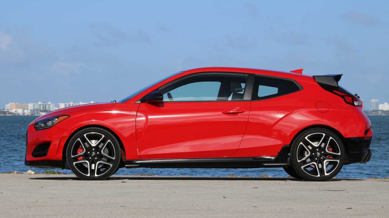

Congrats to poster VelosterN for being fully prescient about this Fun Machine! Crystal Ball of the Year to the OP, and Car of the Friggin' Year for the Vel N, when the C8 Corvette was in the hunt with it. Wow.
[Linked Image]

OilReport99, that's a Hyundai Accent, their cheapest car.
Looks like a dork wearing a hat to me.
Nice car,
The 1.6T 2016 I once owned loved PP 5w30 and Castrol Edge 5w40. Not a big fan of the new body styles recessed line rear fenders. It lacks hips and "junk in the trunk" to me. The infotainment system seems to have improved, but I'm not a fan of screens that arent flush or in the dash, it drives me nuts.
