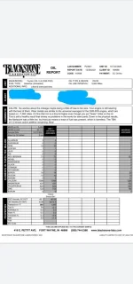

Did an oil change on my dad's truck as an early Christmas gift because his work schedule doesn't allow him much time to drop it off at the dealership.
Until now he's always leased his trucks and usually by the time he's used all his free ToyotaCare oil changes it's time to trade it in anyways.
However, his current truck he actually bought, he's used all his free oil changes up so this will be his first home oil change in almost 20 years lol.
It's a 2019 Toyota Tacoma TRD Off-Road. Mileage on the oil may be slightly off because it's lifted with oversized tires.
Decided to send out a sample for a UOA to show him how it's doing.
Dealer bulk 0w20 and Toyota OEM filter with ~5,000 miles came out, SuperTech 0w20 and a Fram CH9972 filter went in.

Nothing surprising there; good wear and low contamination.
If your dad is comfortable with it, he could easily go to 7.5k miles on the ST OCI with no problem. Then take another UOA and see if further extension is possible.

Good looking uoa. The Oil didn't shear out of grade, plenty of tbn left.
Wear metals are low, Silicon low. You could easily bump the uoa to 7.5k miles
