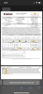

2017 6.7 PSD HPL 5w40 baseline sample (270 miles)
Oct 3, 2010
2,814
RI
I wonder why they didn’t use GC for fuel unless there was none measurable? Ignore comments about the lube, they labeled it wrong, same thing with the filter.
Due to some anomalies in this report I’m sending a sample to wear check after talking with Dave at HPL. It was his idea and he offered to pay. Great company to deal with! I’ll post the report when I get the results.
That oil is a really thin 5w40 with a cst of 12.7@100
That can't be right.
They typically do run GC unless they don't suspect any fuel. I think you can ask them to run it anyways if you want the value and they will.
It’s hard to make out but it says 13.7. There were no issues on a different lab, everything was within specifications. I’ll have my 10K sample within a month or so
