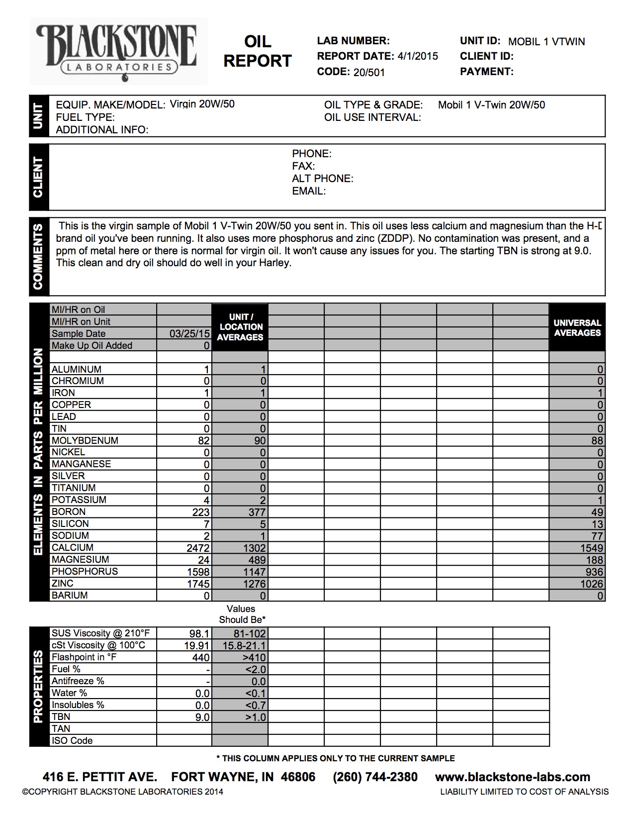

Y'all are welcome of course. On the SE Stage1. I like it fine It made the tone a little deeper. It always ran fine and still does. I installed it BTW... That was easy. On the thickening, I'm going to guess that at some point the insolubles are going to start to rise and the TBN drop. When that will be? Would it go 3 Years? I agree it could go longer. Note also that it starts on the upper end of the Viscosity range already according to the VOA I had run: [Linked Image] We were discussing Synthetic vs Conventional on another thread and the possibility that a Synthetic has a wider natural spread... if we consider the behavior of that oil in contrast to this one, we have a bit of a puzzle at least to me. It doesn't really matter, but it is interesting. I'm completely comfortable with this oil on a 2 year schedule though.
