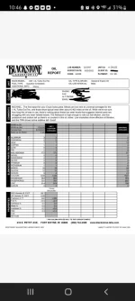

Since I sold my Taurus, I bought this used little 2011 Chevy Cruze 1.4T and other than the normal cooling issues that plague these cars she's doing well. Fixed the leaky hoses and cooling fan and did an oil change. Here's the report of what ever oil was in there. Car was decently taking care of. Guess they traded it in cause of the cooling issues.

It’s good to see the oil in good condition. That supports the notion that it was properly cared for. 👍🏼
