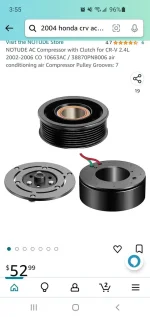

Have you thought about buying a new clutch/magnetic? Cheaper than a new unit and doesn't require the refrigerant to be drained/filled.

I thought about that but in order to replace clutch, you still need to removed it from the car. It is on a real bad spot or location.
If I had a lift, you might be able to do it br dropping part of the sub-frame.
On the civic you have to unbolt the compressor and turn it a little bit to access the pulley. Maybe the crv is harder, not sure?
