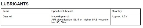

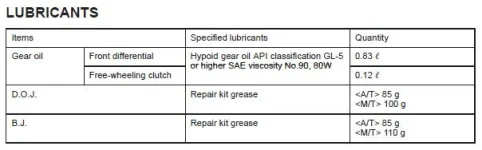

that's all I found
my question is where is mandatory to use a only GL4 oil? where is mandatory to use a only GL-5 oil ? where can I use an approved GL-4 and GL-5?

Manual transmission and transfer case in this application will take GL-4, do not use GL-5. The differentials will take GL-5. You can use 75W-90 or even 80W-90 where you are.
I apologize if I ask for confirmation.
If I understand correctly, a GL5 only oil is needed for the differentials and a GL4 / GL5 is no good
For the gearbox and the transfer case a GL4 only oil is required and a GL4 / GL5 is not good (and I imagined this, especially for the gearbox)
