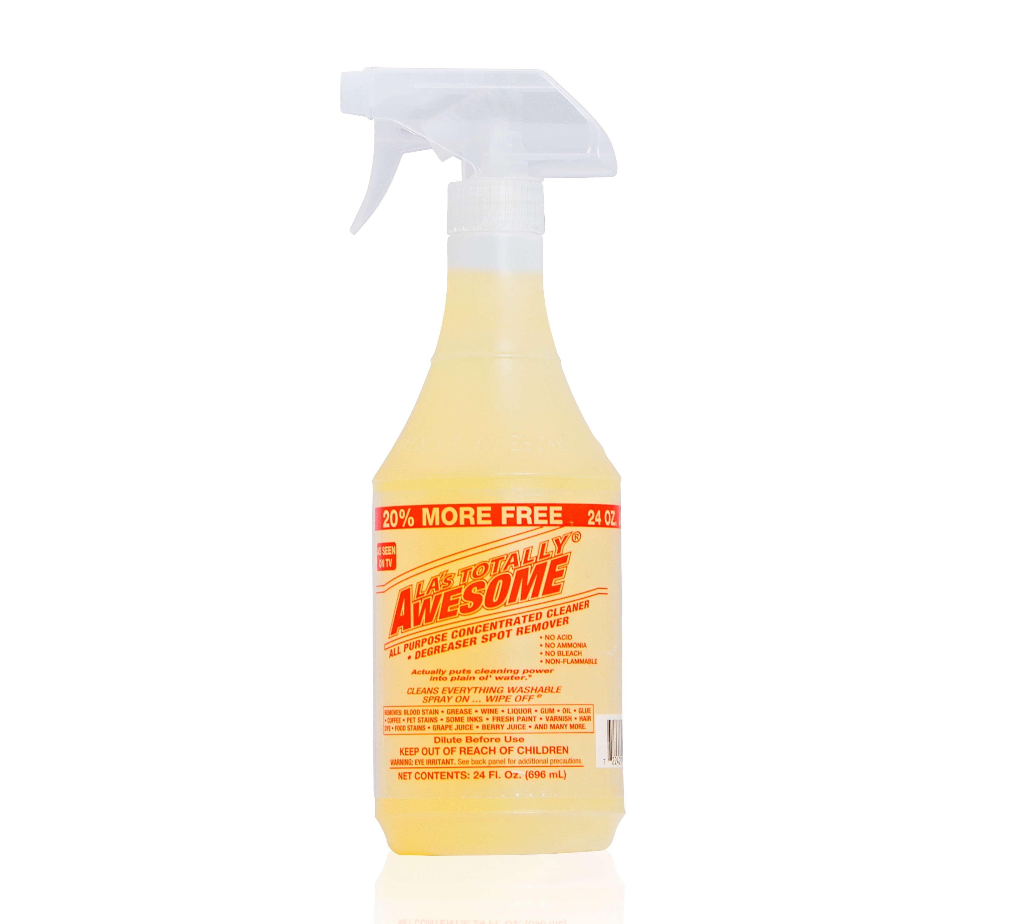

Step I - spray the headlight down good with LA's Totally Awesome All Purpose Cleaner ($1 at the Dollar Store). Mere seconds after spraying the headlights watch the yellowing begin to run off (it is grime and grease). Wipe clean with paper towels. Repeat until all tar, bugs, dirt, grease, etc... is gone. They will look hazy and cloudy but the yellowing should be gone along with anything else on them.

Excellent results and thank you for posting. I do have the LA's Totally Awesome Cleaner on hand. It is very strong and reading the bottle it says to dilute it at various amounts depending on the job. So using it straight should provide some decent results. Also have a nice, new bottle of Sprayway glass cleaner, so two for two so far. Blue Magic has some good products including their metal polish. One of the best carpet spot cleaners is made by them also. Will you be cleaning up the white paint by detailing it? The 05-07 Accords are a top-notch car so might consider keeping both. Parts should overlap a lot which will come in handy. Thank you for sharing.

If ya guys don't have or cannot get LA Awesome, any high PH caustic degreaser will work, I use Zep Industrial Purple and it seems to work much better than Awesome but obviously costs more.
