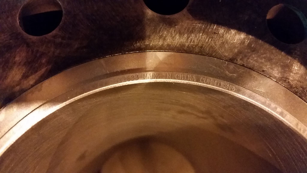

Originally Posted By: jeepman3071
Originally Posted By: motor_oil_madman
How does a water pump catch fire?
This...
The outer bearing is likely the faulty one. The one that supports the pulley directly and carries most of the load from the belt and fan.
Mar 4, 2017
25,332
Would a water pump bearing overheat and then cause a engine bay fire? It seems to me it would seize up long before that.
