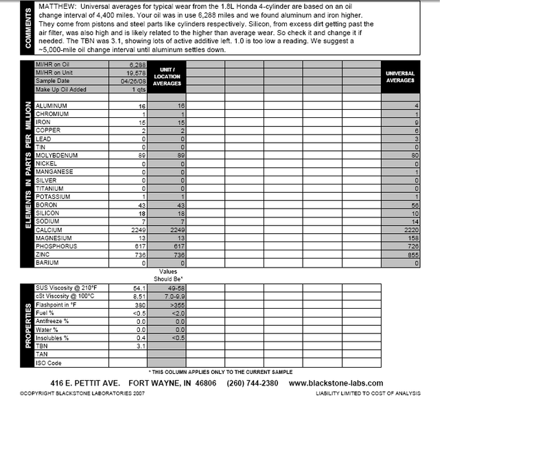

Well, I am testing the maintenance minder system in general, but I don't want to "test" it on my CR-V, so I've been testing it on my company car, a 08 Civic LX 5AT. I'm surprised about the high silicon levels since I replaced the air filter with a stock one just before this oil sample started. I'm interested to see if my metals continue to be high.
Anyone else have results similar with these? I'm already starting to doubt the MM system...keep in mind that my MM just started displaying 15% 200 miles before I took this sample, so this wasn't even down to 5 or 0%.
ps. M1 extended performance oil filter
