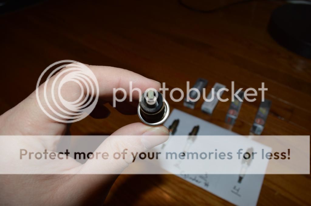

The maintenance minder has not indicated that the spark plugs need to be changed, but I've had the plugs since right around 100k and figured it was an easy way to determine if this was the cause of some of my hard-starts. Information: Car: 2008 Civic LX Miles: 103265 (purchased @ ~60k miles) Plugs: IZFR6K-11S (Ir) Miles on Plugs: 103265 - The PO kept very good records and because he was not mechanically inclined, took it to the dealer for EVERYTHING. There was no record of spark plug change. Issue: Car will take longer to crank before catching, and when it does catch, it will sometimes stumble for a second. Placing the key in ON (without starting the car) for a few seconds seems to help, and cycling the key OFF and then ON a second time provides no discernible change. While changing the plugs I added a dab of dielectric grease to not only the spark plug terminal, but also the coil connection. For good measure, I disconnected and reconnected every connector accessible from the top in the engine compartment. There were no visible signs of corrosion, but I figured it would be a good measure to take. This also stems from some trouble-shooting resolution being as simple as removing and reseating a card to fix sporadic faults. Finally, electrically, I cleaned the battery terminals and re-applied dielectric grease before restoring the battery. This reset the ECM in the process... Other Other: Just after I had the car dropped off at the dealer to update the TCM (read about an update online that fixes minor shifting issues, which we've been experiencing) and check for ECM updates. The dealer found and installed an TCM update: NAA670 I can't be sure if its simply a placebo effect, but with the above done, the car seems to start better and shift better. A lot of variables, I know. And while the spark plugs shown below all are within their spec'd gap and look fine, who's to say whether they were performing at 100% or if their performance was much more degraded than appearances would lead me to believe. So, here are the pictures, open for comment. Cylinder 1: Cylinder 2: Cylinder 3: Cylinder 4:

Plugs look good for that mileage. The issue with starting is probably because the plug gap is 3X what it was originally. My Tacoma with iridium plugs, the gap was 4X original at 70K, but it is subject to a lot of towing. But it still ran fine.

Also as the spark plug gap get bigger the easier it is for the spark to take the easiest path to ground.
