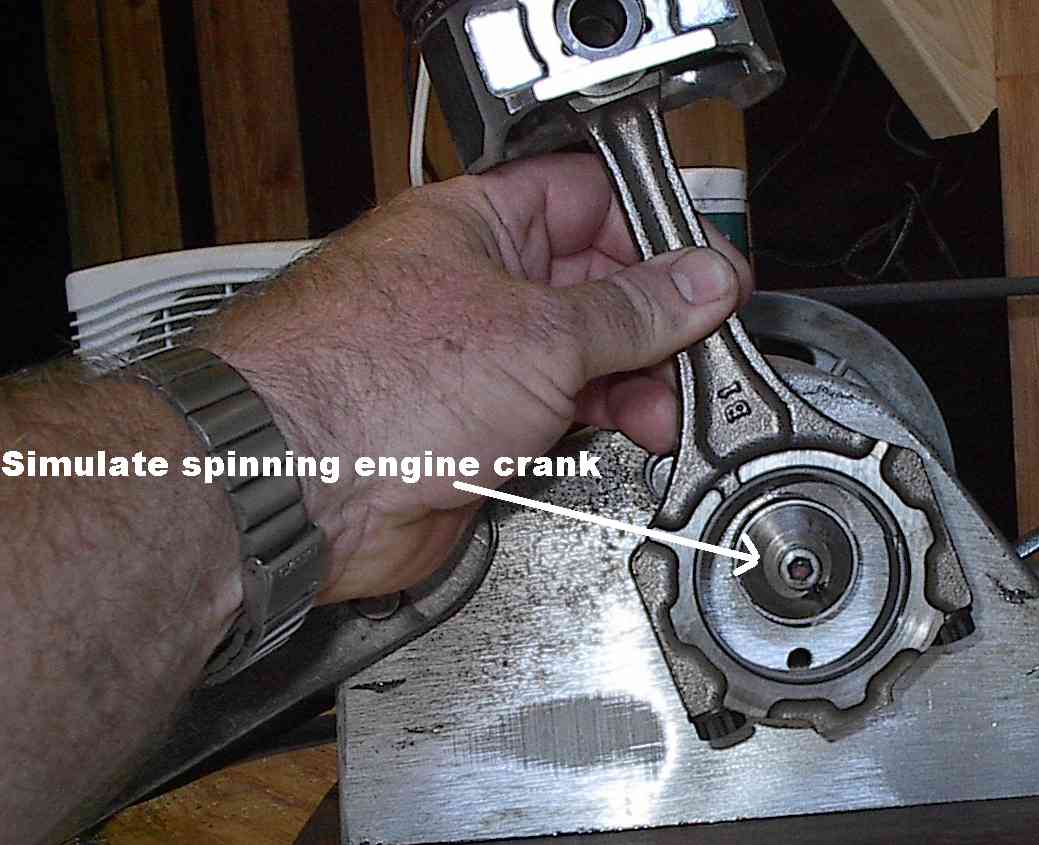

The basic principle behind this is the rotating bearing race is like the crank in an engine.
piston
So to simulate how it looks, you put your test oil in the little pan (like oil pan on car), turn on, then apply pressure to the lever until you squeeze out the fluid and stop the machine from rotating.
