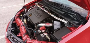

Next, drain and fills on these things are only 2.2 quarts per drain and fill, so one is not enough, I need at least two more, then I'll call it quits for another 30k. And, as far as oil changes are concerned, 2k is cool, because I have a short ram air intake, which is much dirtier than the stock air intake ,which also has a gause-like pre-filter attached. In the end, my oil does get a ever so slightly darker than it used to vs. when I had my old stock air filter set up on. And with oil being recycled, I find this a very cheap way to keep the engine spotless.
